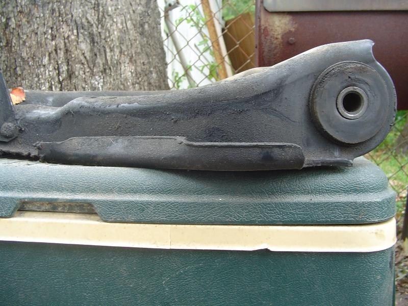

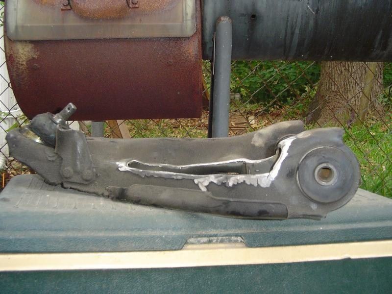

Hey guys I have a 95 chevy bagged on 20's Does anybody have any pics of there modified stocks arms Im dehumping my lowers and was wanting to see how everyone else is doing it

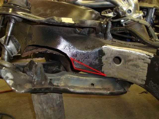

There is no need to dehump arms on a fsc. You can pie cut the frame behind and in front of the spring pocket in like 15 mins. Cut a slice out, hammer the bottom of the rail up to meet it, and test until you have enough clearance then just weld up your slice.

what year is this fsc in this pic the upper control arms look crazy - the lower slice and push up idea is awsome

Looks like a 88-98 frame
