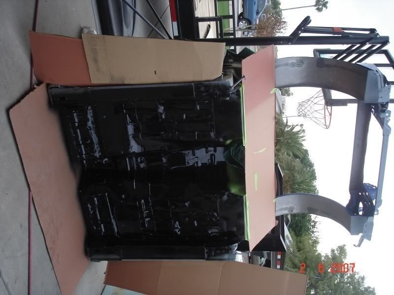

Uncle Fester's avatar
Uncle Fester
SSM uploader didnt work had to upload to PB, this is under the cab.
