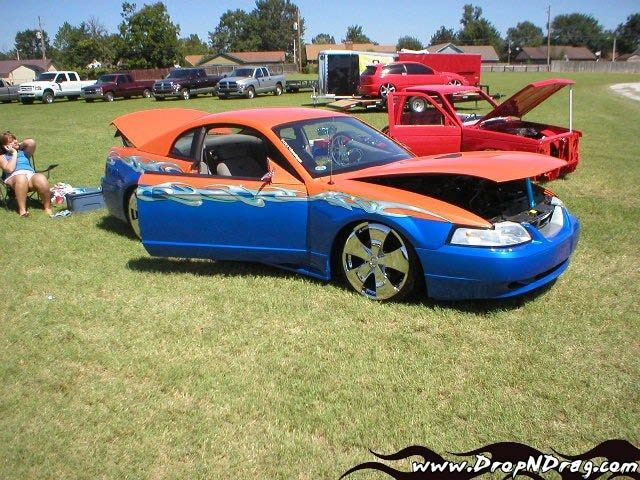

seal it in silver. they have a nice one. check out my mustang it was the same colors you are talking about using.
