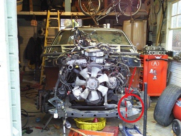

I also would like to know how do you body drop the front of a mazda b2200? im gonna channel the cab and tub it and body the bed.

 Cut these frame ears and drop them the amount of the body drop and weld them up and gusset the bottoms. you will probably need to make a notch in the front cross member for the radiator hose. Stomp on the gas and stalls sounds like a fuel prob. It may be dirty secondarys in the carb maybe even just dirty fuel filter.
