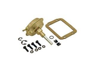

what year and model? could be a bad 4wd actuator

dorman part number 600-202
Product:4WD ActuatorDescription:Plug Configuration:Contents:Includes gasket & clips (doesn't include harness)Brandorman - OE SolutionsApplication Notes:Front; 4WD; w/Dana 60 Front Axle; w/Disconnect
