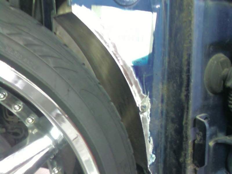

just got a 06 silverado reg cab v6. im going to bag it. wondering if i have to tub the fire wall for 24s? what about 22s?
IMLOWER's avatar
IMLOWER
yes yes
draggintouge
even if im not doing a bodydrop?
F
foedoeblaza
if you want it to lay frame then yes
coleskezzie's avatar
coleskezzie
Def have to on fours. Twos just need a little bit of a tub, its not bad. Check out the new streettrucks, i layed out that black 01' on fours in there at the shop. it still has factory heat and a/c too.let me know if you have any questions!
innovationbydesign<&gt's avatar
you can keep the factory heat and ac all the way up to 28"s
treylos's avatar
treylos
 here is my '03 sierra on 22's but it is set up for 24's.. It wasnt too too much work. u lose ur ebake. other than that every thing stays the same.
