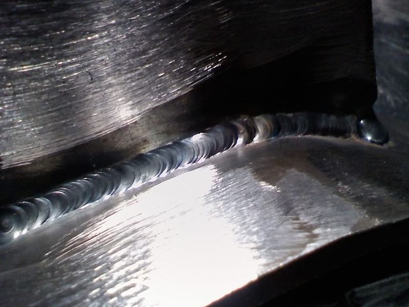

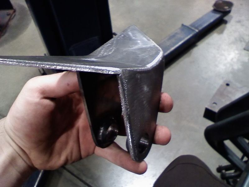

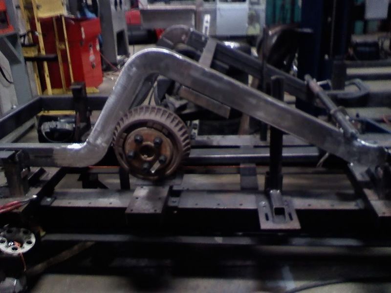

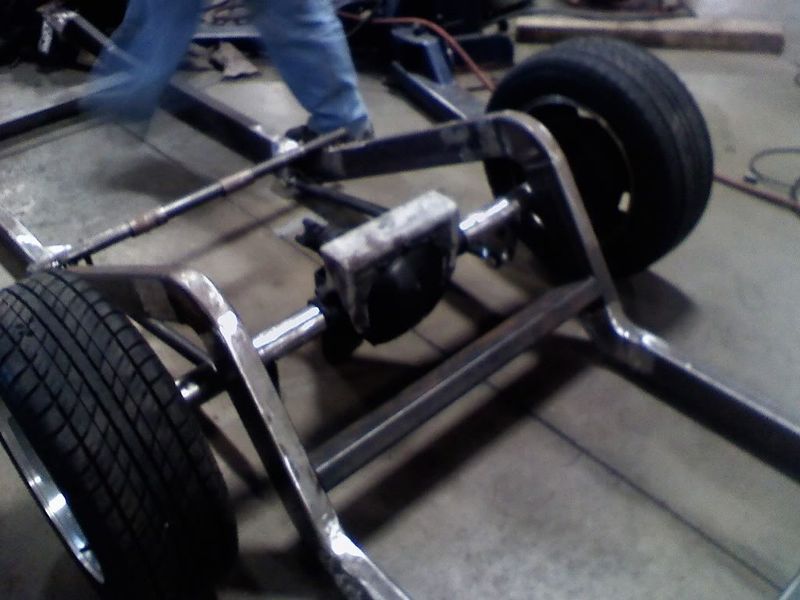

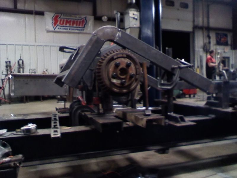

Edited: 6/21/2010 2:15:31 AM by jucieddime00im only 19 and this is my first build let me know what you think so far 2000 s10 sfbd all work performd by myself cant figure out how to post pics but heres the lik to my photobucket.....http://s1047.photobucket.com/albums/b476/dkrider15/?action=view&current=truck142.jpg

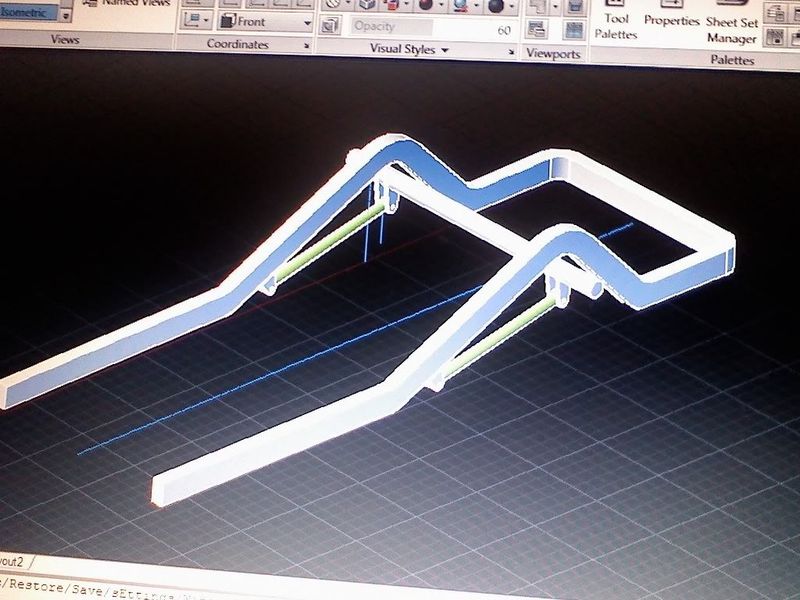

I looked at the pictures in your photobucket and it looks like your doing some nice work. Have one question in the build pictures and your 3d model I only see the two lower bars, are you planning on making a parallel or a triangulated 4 link?
lunatiksblazer's avatar
lunatiksblazer
    Heres a few pictures from your photobucket, after looking again it looks like your planing a triangulated 4-link.

looks like a great start.. are those "welders series" 90*s?

im going to be running a triangulated 4 link thanks for throwin thoes up there for me and the welder is a powermig 255c

he is asking if the 90° 2x3 bend is from the "welder series"? http://www.welderseries.com/catalog/popup_image.php?pID=420:WCN:

no i hammer formed them all out of 1/8 in plate if you use the ones like your talking about the only way to get the same radius on the corners of the 2x4 is to grind all your weld out and is not structurally sound i made both sides of the bend then used 1/8" x 3/4" strip on the top and bottom of the curve
