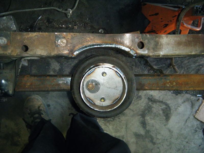

Can't you guys section the frame out and replate it and center the bag over the bar?
nissandoordragger's avatar
nissandoordragger
^^^^^exsactly do it like i did thid ranger
