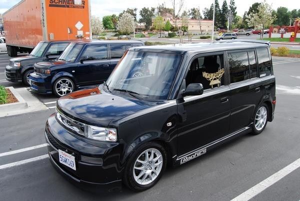

Before I bagged my box I had Tein S-Tech springs. Its a drop of 1.65" in the front and 1.5" in the rear. Heres how it looked on 15's And If you change to Toyota Echo struts in the front and Sienna shocks in the rear it gives u a extra inch of drop.
