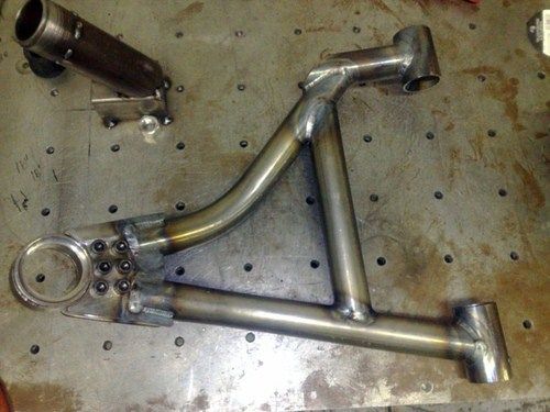

yes u have to tub the firewall, and u will need spindles and tubular uppers and lowers.

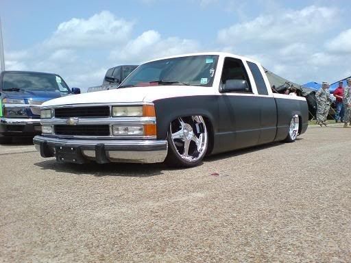

you can use tubular control arms but you dont have to the stock ones with drop spindles work just as good if you wanna save a lil cash flow you just have to dehump the lower control arm so it doesnt hit the frame when layed out i ran 24s on my 96 silverado it was bodydroped and layed out fine
