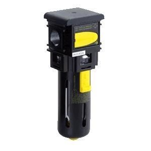

 Grunion Asco Water Trap ASCO filters are designed to provide your air suspension system with top quality air. By removing water and particals from the air, the filters give that maximum life to your other air suspension components. The ASCO water trap features a semi-automatic drain which allows for simple removal of filtered water. High flow rates maintain air suspension system speed. Metal bowl guard protects the unit from breakage.

parker has the auto draim water traps they are only like 30 bucks. you can get them at your local parker store. it looks almost like the smc water traps but have metal bowls.
