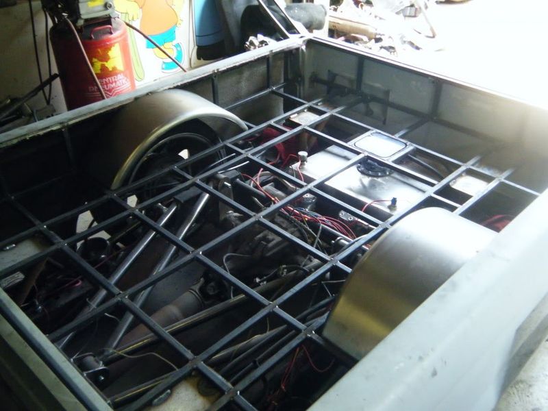

 on my mazda i ran 1.5 x 1.5 x 14 ga tube across the floor and welded to the ribs. ran the tubes little longer than the inside of the bed rails.then for the side sheetmetal i ran a pc of 2" flat galv up to the bottom of the bed rail and welded there. solid! ran pc of angle iron from front to rear to weld side sheet metal to.
