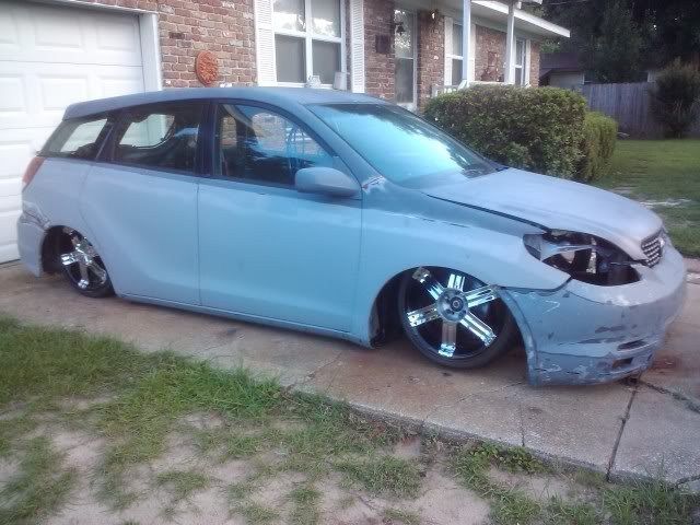

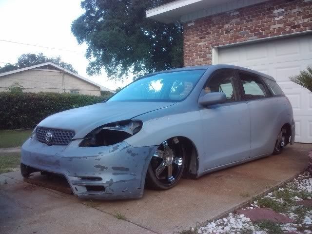

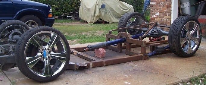

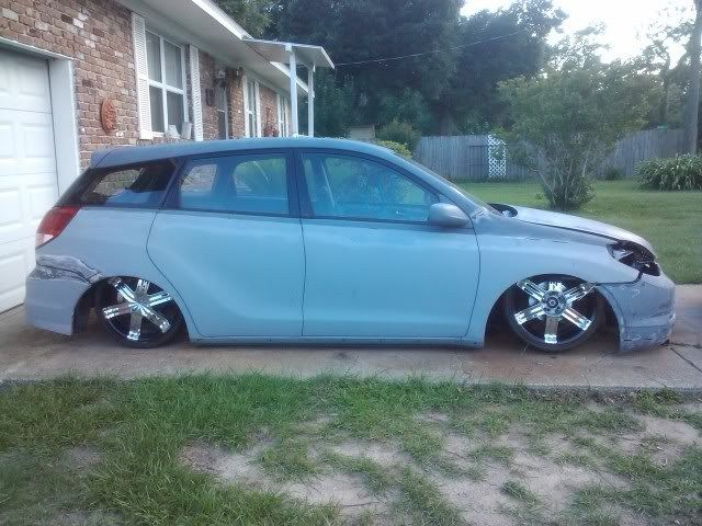

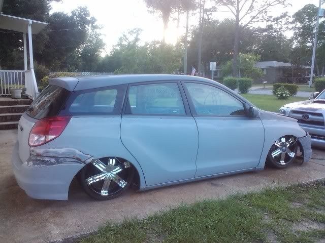

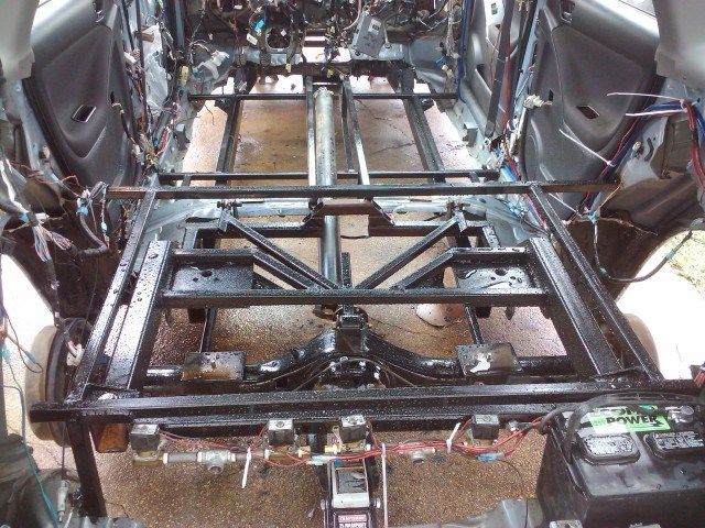

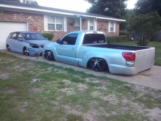

my current project 03 matrix xrs thats WAS bagged and fwd when i got it .........NOW its rwd on a 2x3 chassis bagged and bodied no more skirts on this chick  it will be getting a tacoma 2-rz engine ...getting lots of work done but still plenty to go

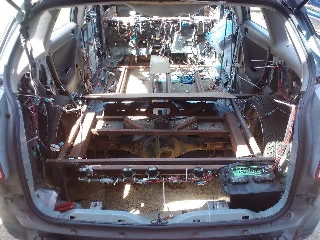

thats badass! looks good so far, got any pics of the floor and how you mounted the two together?

wow.. was not expecting to see that.. THATS AWESOME!! keep it up, would love to see some rolling shots of this thing..

---------------------------------------------Originally posted by JuicedWagonthats badass! looks good so far, got any pics of the floor and how you mounted the two together?  --------------------------------------------- heres the floor framed up ....still havent skinned the floor still need to run lines and exhaust   ...easier w/o floors ...i framed it out with 1" box tube and made body mounts on the frame and in the 1" framing then bolted it together
