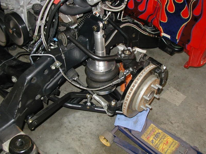

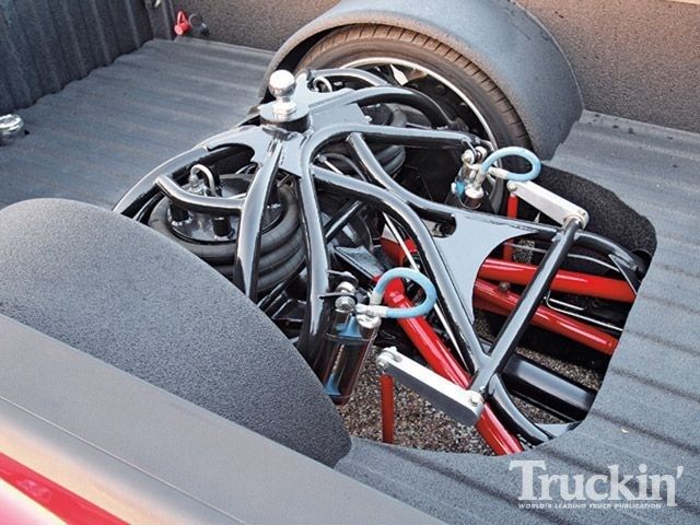

you have any pictures of how you plan to do the sway bars and not limit travel?
thacru78's avatar
thacru78
Front will be similar to this.... And rear similar to this...
