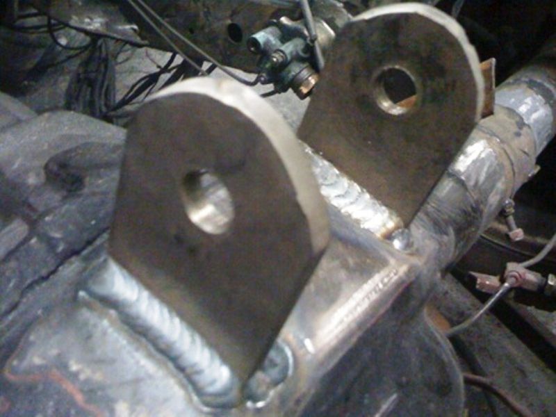

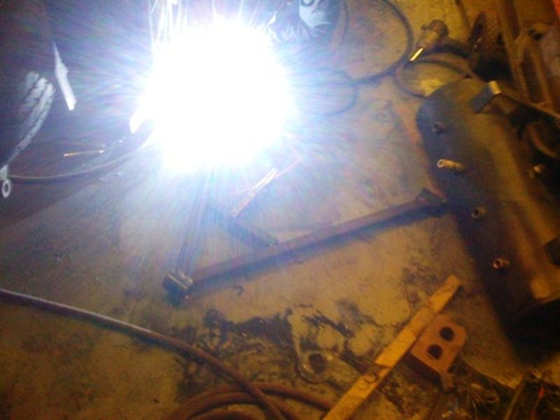

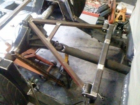

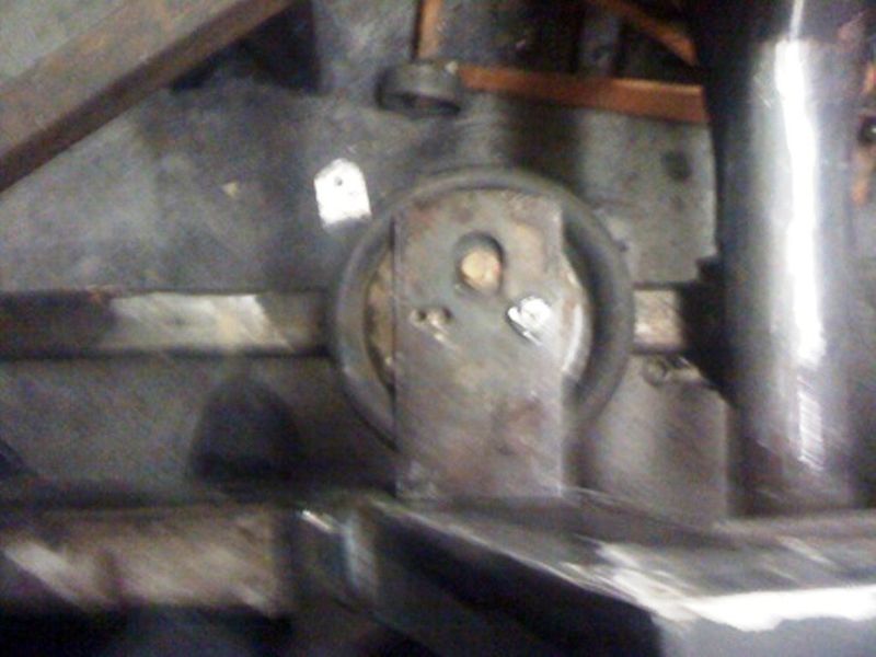

   notice the house wire nuts the bubble gum welds  more bubble gum The entire two link was welded together so the u-bolts were useless  factory shackel was dragged through so they just welded bolt in in solid another pic of bolt welded in some people should not own a welder  after we had to plasma cut the two link offfactory  u-bolt perch welded to two link This is how we got the truck and we will be posting updated pics of the redo of the rear suspension

atleast they knew theirwels were shit thats why they used the ubolts i guess ...anypics of the truck

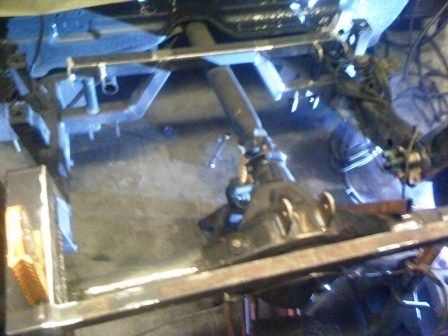

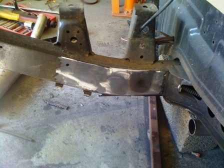

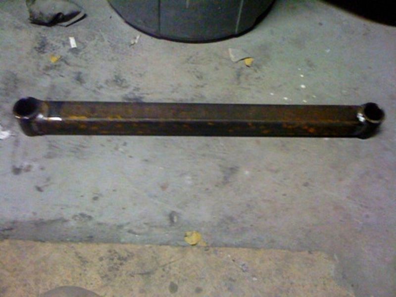

cleaning up the frame  front crossmember

awesome looking work!!

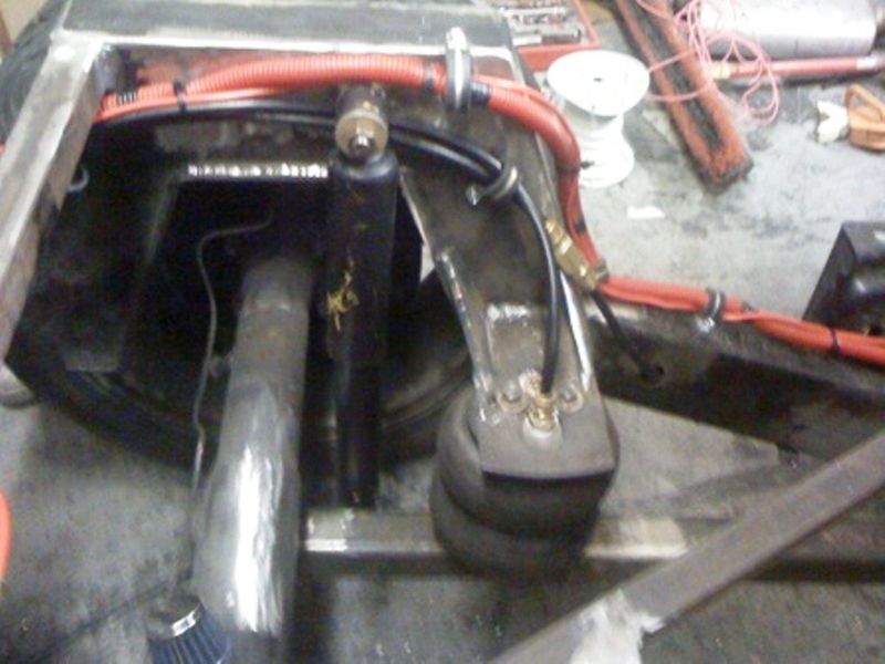

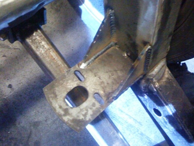

You should extend the gussets on those bag brackets to at least the centre line of the bag for strength. Builds lookin good though, good luck on the rest of it.
