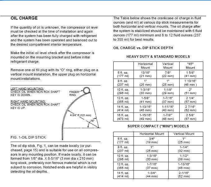

how do i check it and how much do i add
baggednbad91's avatar
baggednbad91
there should be a 9/16 (i think) bolt in the left side of the block you can unscrew and make a lil dipstick to check the level. i think a 1/4 or 1/2 qrt is recommended. just dont let it run out of oil... i can hear a difference in the sound of mine when it needs to be topped off

They take 14oz of oil, never let it get lower then 6oz.  I wouldn't recommend recycling the oil that gets in the trap, that shit is nasty and smells like shit so I am pretty sure its not very good for the comp. For instructions on how to make a dipstick, here they are straight from the service manual for yorks. Just use a wire hanger.
