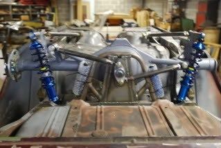

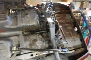

I too would be interested in Max's response, but I believe Joel is correct treat it as you would a rear end mounted pivot.  These are pics I had saved to my computer, kind of liked the look of the chassis mounted pivot, of course this was on a coilover setup on a "pro touring" car, and it's mounted to the body.

I've always understood this to be the superior method. Your roll center height will not change with your suspension travel. On the average bag job though, most people aren't very concerned with handling, so the method we commonly see on bagged vehicles works fine.

we have run a chassis mount on a truck here with coil overs which is set up for road and track use pretty much for all the reasons seth has stated.   I think on the aussie V8 supercars the prop is mounted to the chassis but is adjustable to raise and lower the roll centre, maybe try check one of those out if you can??
