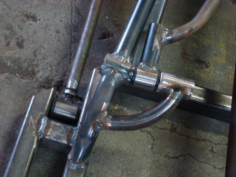

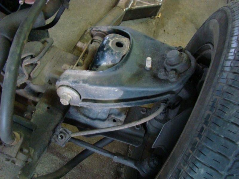

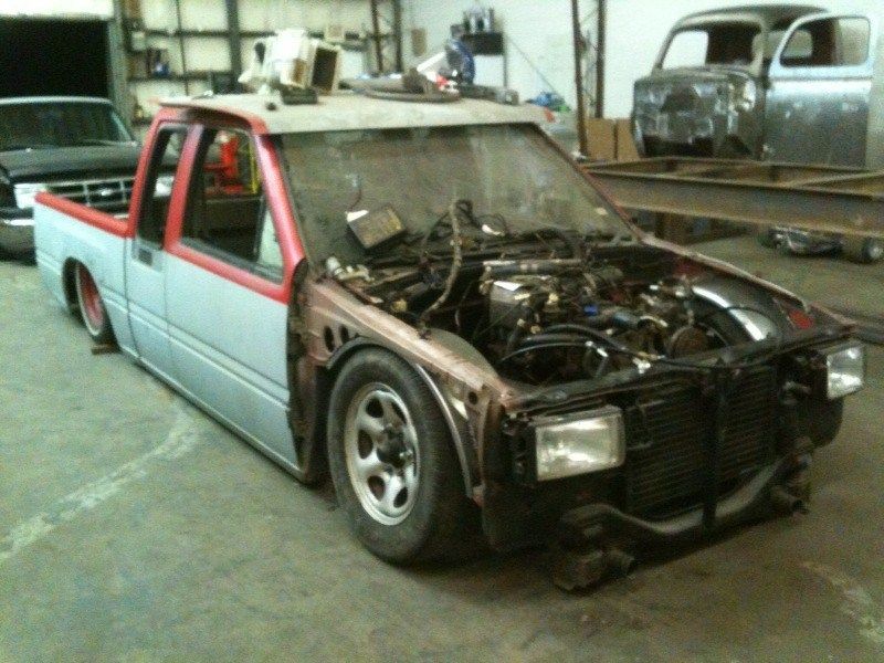

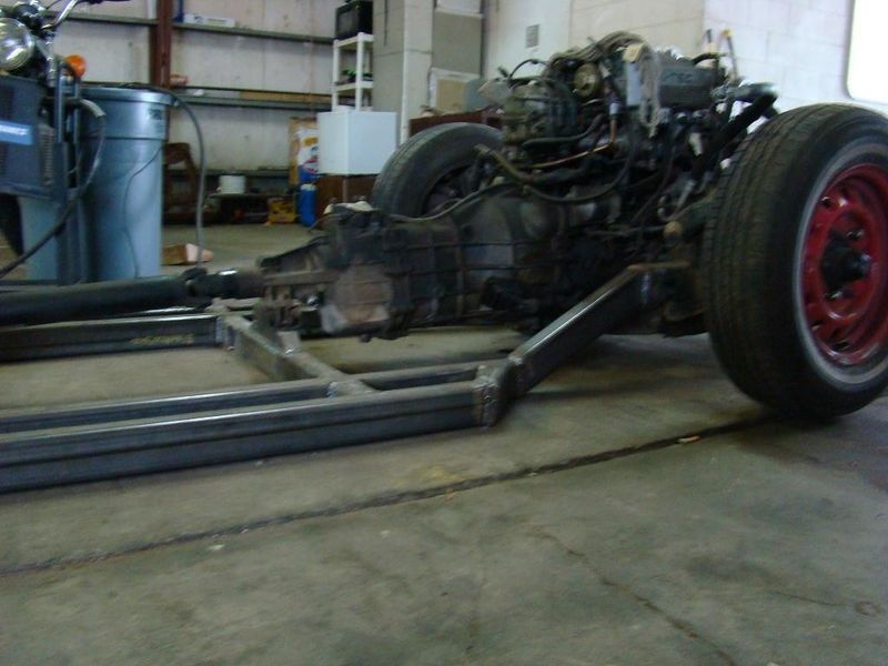

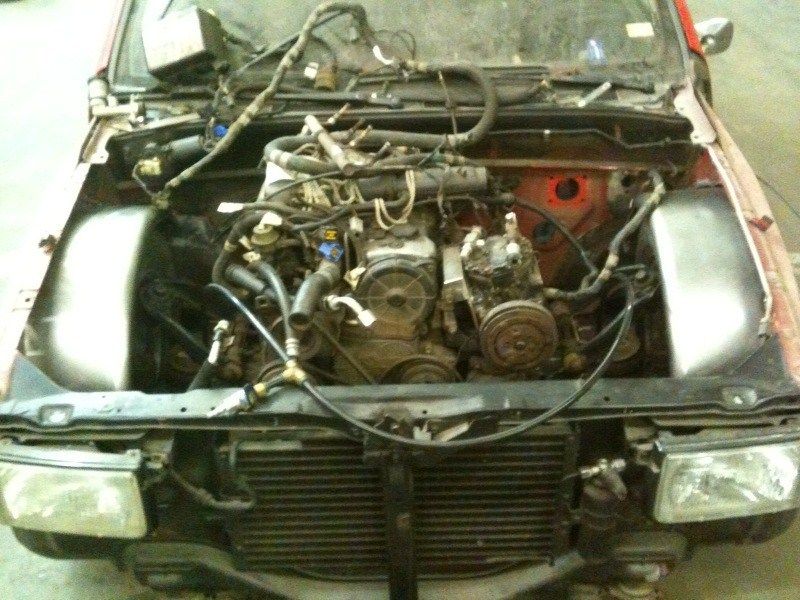

Well, I started posting pics in the Isuzu area and decided to start a post here to put my progress pics on. I have been working on it for a little while so Ill put all the pics I have up to this weekend up. This first pic was when I first got it home.

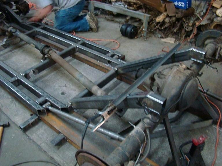

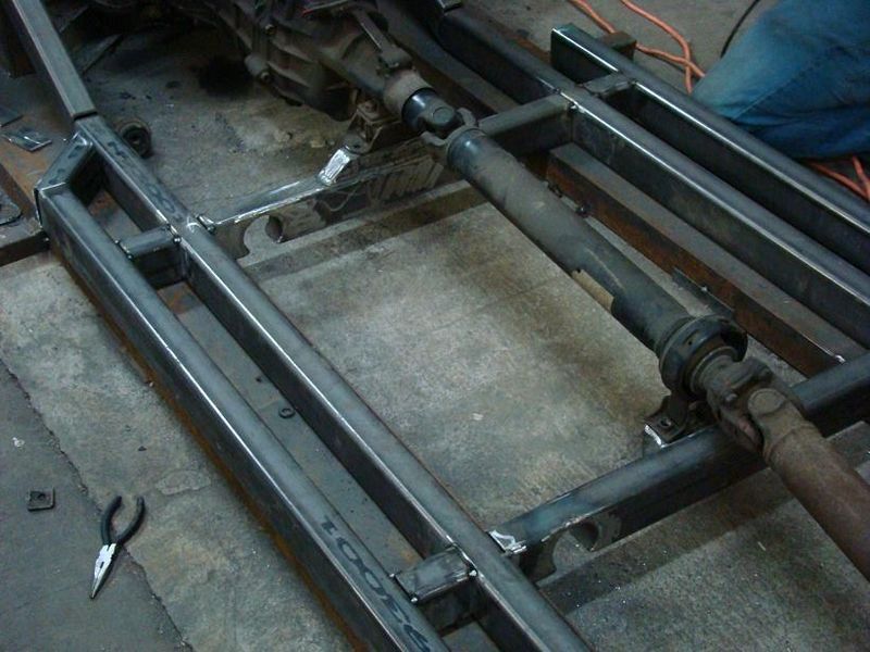

I have the frame setting on 2x2 square tubing and have the front mocked up on stilts that way when I cut the rear clip away I get my 2" Z in the front.

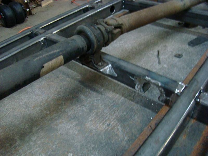

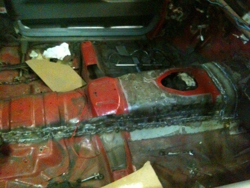

Here is the carrier bearing welded in place before cutting the frame away.
I love the disc brakes.

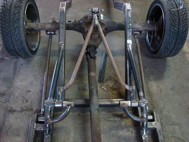

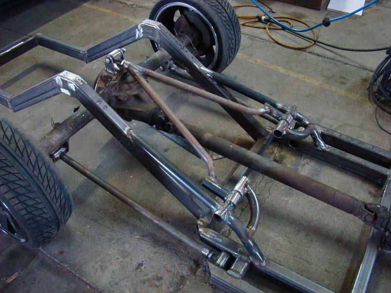

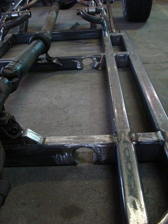

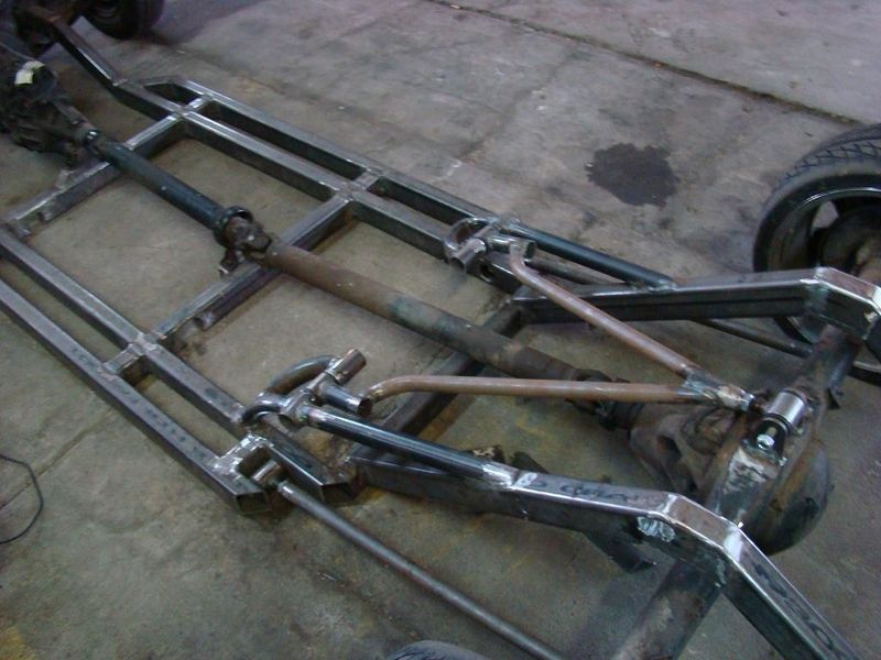

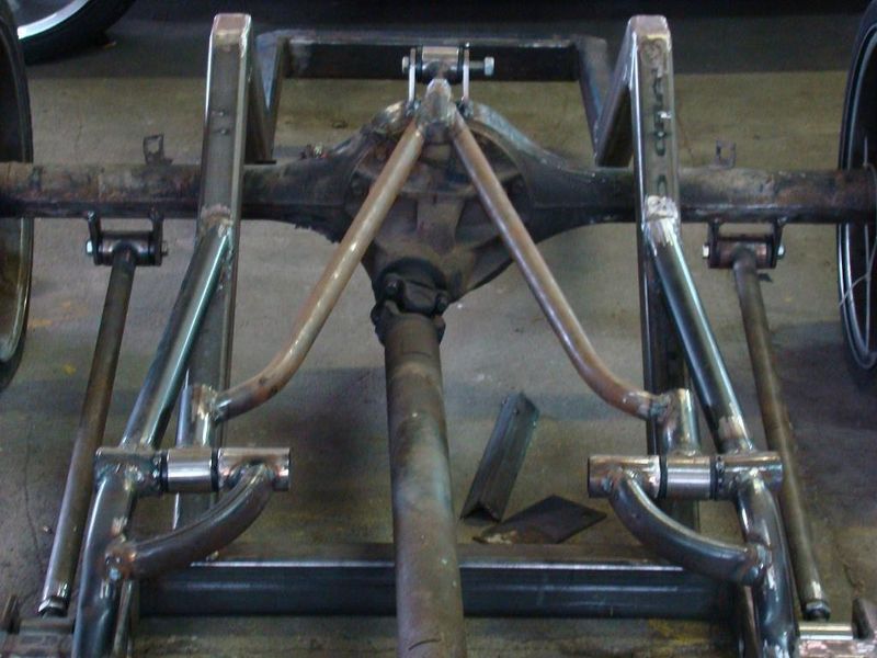

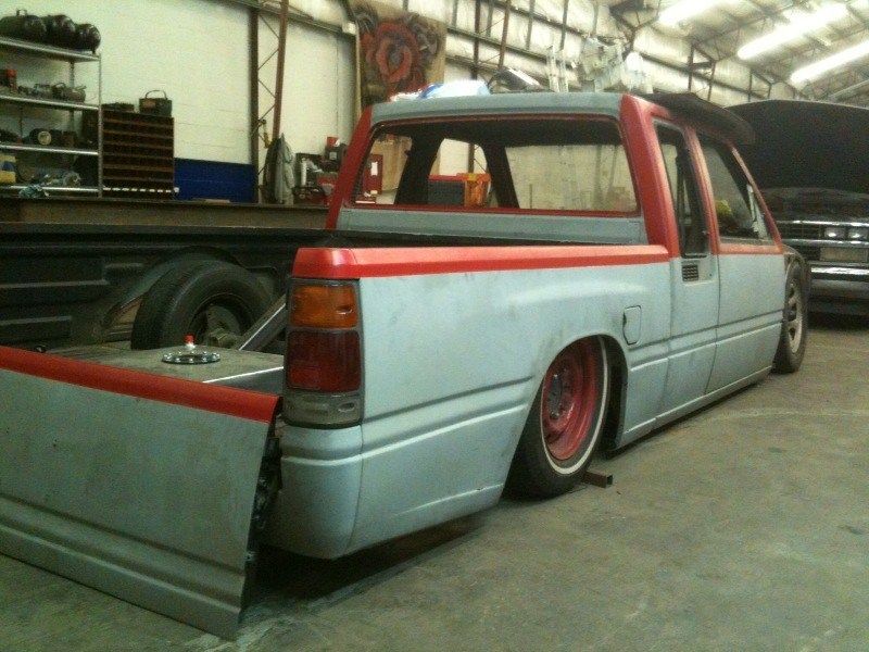

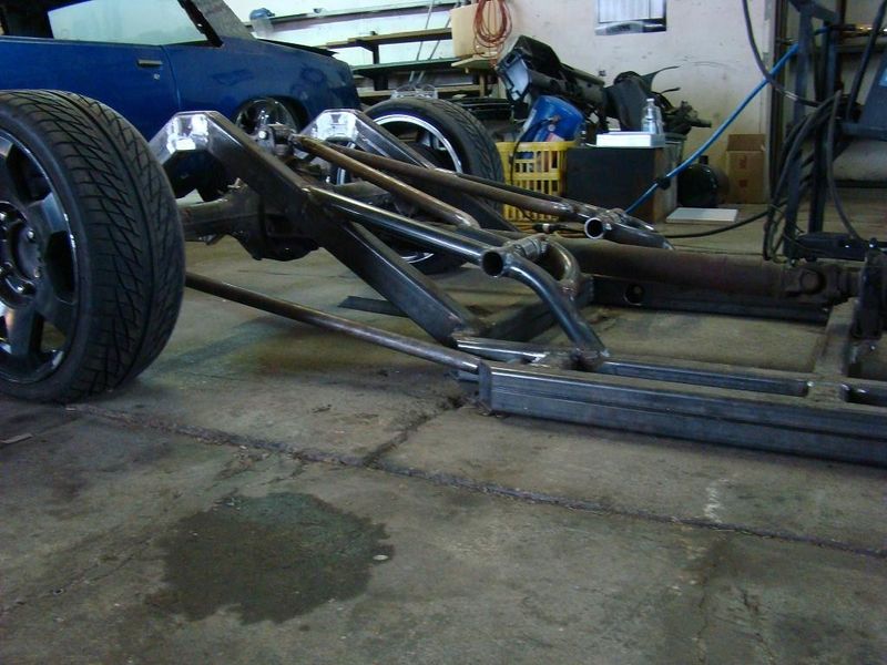

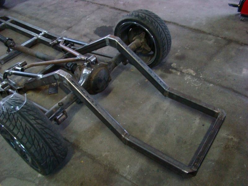

Here are more pics of the build. These are the most recent so this is how it sets now.             Thats all for now. Until next time.

Very nice. I always wanted to bag a spacecab but i ended up doing a single cab zu and daily driving an 88 ls spacecab i picked up after i started the single cab. Your frame looks good and it should be beefy as hell, i like the front lower 4-link mount too.

i like the way your frame is coming together, and the disc conversion in the rear
