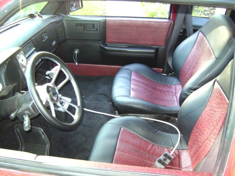

disfiguredS10's avatar
disfiguredS10
 I used the SEM dyes on my old s10 and took everything from dark gray to white. it took tons of prep and cleaning, but it turned out good.
