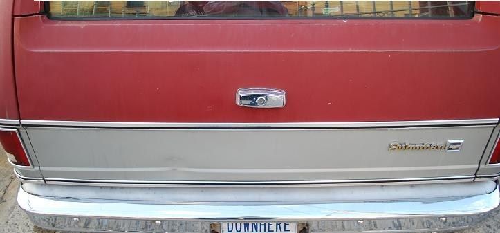

thanks for all the info!  well the paint is original and 31 years old... so it has no clear.  I was told if i was to compound it, it would give some kind of a shine...  I plan to do body work and paint, but that will be in a year or two.  here is a pic what im talking about...when it rains, its nice and shiny!
AZ ARTWORX's avatar
AZ ARTWORX
compound is what you use you can start with a wool pad and 3m. then go to a a maguires red foam an the same compound. go to a black 3m foam with dark 3m glaze. finish it with blue pad and ultifinathen wipe. being that the paint is ild it will probably burn it everywhere my advise is to wait til you paint it.
Mulligan
depending on what level you are going for. The easiest/safest method that gets good results, is a DA or orbital polisher (you can sit it on the truck forever and never burn through), a compound like System One X3 or Megauiars Ultimate Compound, clay the truck, then polish with one of those, then hit it with a wax....obviously if you need to cut more than that, then a rotory buffer and 3M or Meguairs cutting compound, followed by polish then glaze/wax will do the job, but be very careful not to burn through the paint!
Dirtysouth10102's avatar
Dirtysouth10102
I would use a rotary with a foam cutting pad and Megs M105 first and if that doesnt cut enough then step up to a wool pad.  PM me if you need any more info, i own a mobile detailing company!
