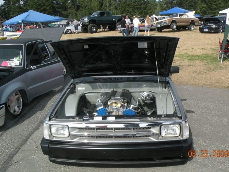

---------------------------------------------Originally posted by DroptSdimeI'm using one of the hotrod boosters on my Mazda.  The bolt pattern is smaller then the factory one so you have to drill new holes for it.---------------------------------------------POST MORE PICS of your Truck in your Profile! Looking Good!
bagdb2200's avatar
bagdb2200
Scott, I got mine from ebay.  I ordered it a while ago before waylayed even sold them.  I don't remember the seller, but there's alot of them on ebay.  Just find one with the best price and a decent feedback if you go that route.  Also for mine the rod on the back was too short to connect it to the brake pedal, but we just welded an extension on the back of the pedal for it to hook up.  I don't know if being BD'd effected that at all.  I don't think it would have. Kerry,  I'm just a bronze member here so I can only post 5 pics on my profile.   Here's a link to one of the build threads though. http://www.s10forum.com/forum/f30/baggain-a-b2200-yay-241044/index4.html
