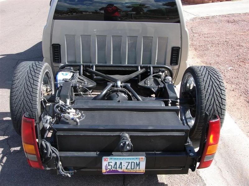

thedivineguy
Edited: 1/28/2010 6:17:54 PM by thedivineguy
Edited: 1/28/2010 6:11:28 PM by thedivineguyi would buy a fuel cell! It helps the geometry of building a 4 link and also if you check on gmfullsize how many people have drug through their tank! It's no fun when that happens I bet! Justplaintrick builds fuel cells for them utilizing the factory pump and sender!
