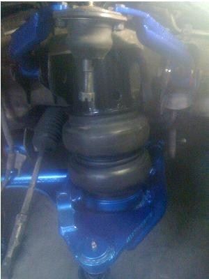

I don't know if you will have problems using both.  I just used spindles on my 2nd silverado with bags and it layed out.  Your arms look sick.  If you were interested I would call Ekstensive Metal Works in Houston and pick up a set of the Silverado front bag mounts.  You cut off the spring pocket and weld them on, they look really clean and you don't have to use any cups or anything in the front. I think it's $40-50 for a pair.  The front mounts look kind of like these......

thanks for the compliment. that does look sick and more one-offish...good idea. thanks bro...
