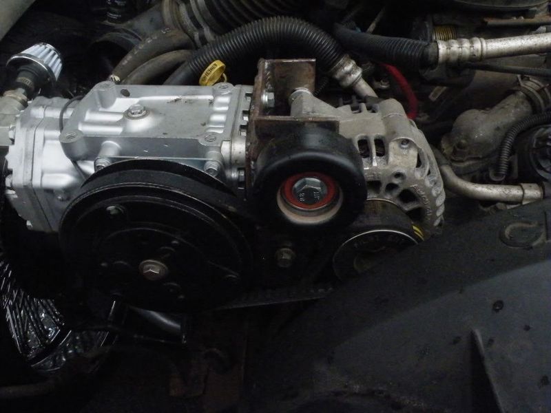

I will make and sell you a bracket for each of your rides.  I made my fathers and it works perfect.  I actually was going to start to produce these but I didn't see enough of a demand for them.  PM or email me at drupru22@aol.com and we can talk about it more since I only get 5 posts a month.  Here's a picture of the one I made for my dads 97 Fullsize with a 5.0L V8 engine.  Here's my photobucket of the entire build up of my pop's truck: http://s254.photobucket.com/albums/hh93/drupru22/?start=100
