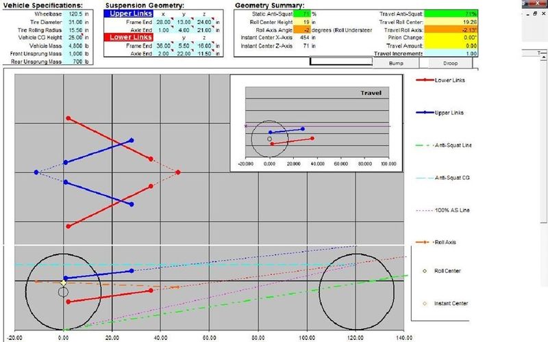

Thanks for the info.  After measuring my workspace I came up with a rough design which should fit under the truck. Everything is based on a frame right height of 5" off the ground. The instant center is way out front, which from what I have read is fine for a street driven truck and shouldn't affect anything majorly. It incorporates that slight forward roll axis slope of -2* which I think should be plenty to help the truck in noticable cornering advantages. My questions are, 1.Do you think that the roll axis slope is fine? 2. In the "Geometry Summary" box are the numbers in the acceptable range for a street driven truck? Sorry for the picture being blurry. Thanks for any replies.
From what I can tell, it looks like what you have calculated should work fine. There really aren't any difinitiave numbers for the questions that you are asking, but I think that whar you have could work well.
