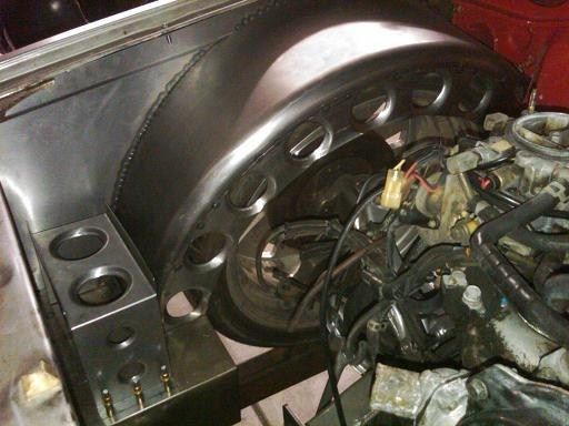

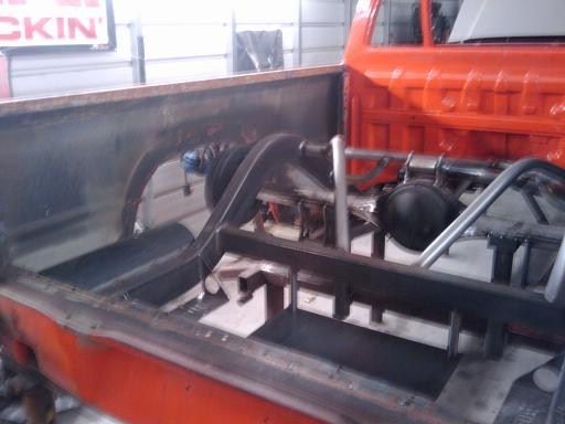

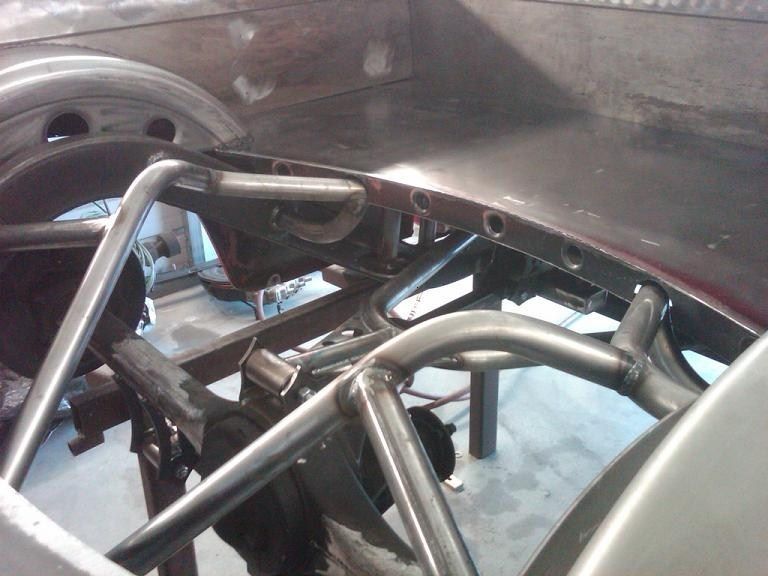

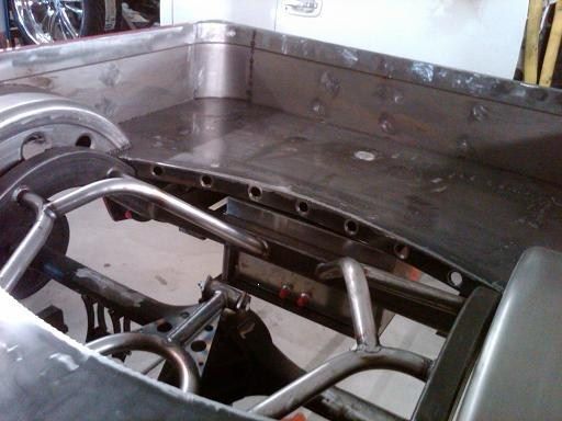

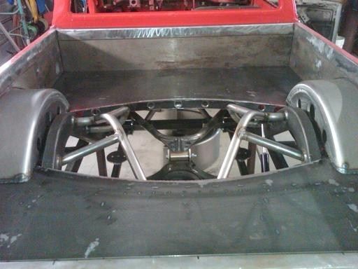

depends on what u want and what you have to start with. My set ups start at 1500 and go up from there. but most beds dont go over 2000.these pics are of a recent bed and what i started with.

thanks... i reversed the mazdas 1/4" bodyline from the outside sheetmetal to the inside sheetmetal of the bed. I did the same to the inner fenders as well. the floor of the bed is done with 1/8" plate so not to dent by anything thrown back there.
