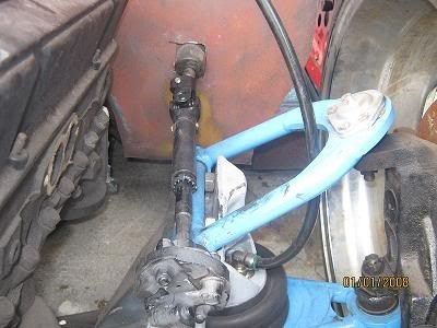

yeah i got drop spindles too...i have 2wd sheetmetal. and yes they do make u positive camber when up... but stick a 1in spacer(actually a nut as u can see in the pic) between the cross arm and the frame where the arm bolts upi tuck 19s with like a 40 or 45mm offset

19s 2wd sheetmetal with 40 or 45 mm offset
