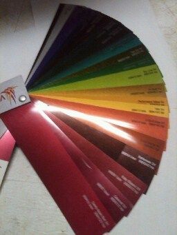

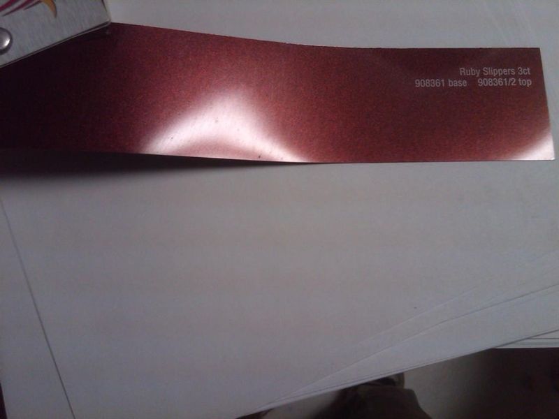

It is just tri coat over balack here is all there tri coats and then just the ruby slippers not in sun tho sorry
