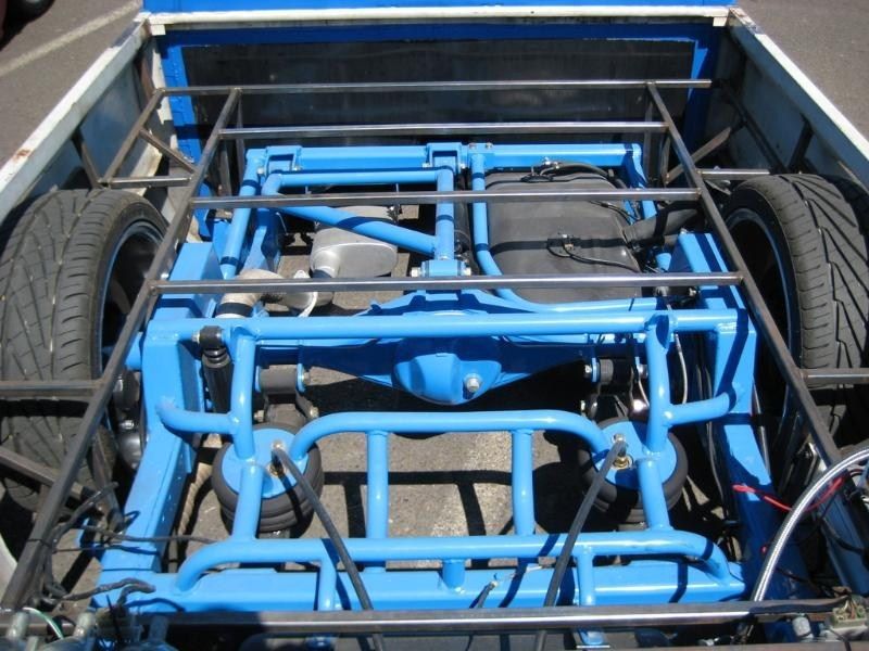

you could do a link similar to this............you could run the bottom bars forward to the leafspring hangers and ur upper link would allow for your gastank.

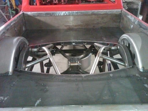

I'm just going to throw this out there, but IMO the current setup you are running is truly unsafe.  People will argue this but only with statements of "I have been running that for x amount of time with no problems, or so and so has had any trouble"  At the end of the day though you are putting those leafs under stress that they were clearly not intended to see, especially if you have removed any leafs and/or are hitting sides with that setup.   If you feel that a 2 link is the only suspension you can run and meet the other requirements for your vehicle, then so be it.  As mentioned by Seth, you will have to run some sort of setup to locate the rear side to side.     You clearly are not laying frame currently with the small notch you have currently, and maybe that is not what you are going for.  However I would suggest that you consider just raising the bed floor, this would give the appearance you looking for I think while allowing you to run a better rear suspension such as those posted above or a triangulated 4 link.   Just some more options for you to think about.

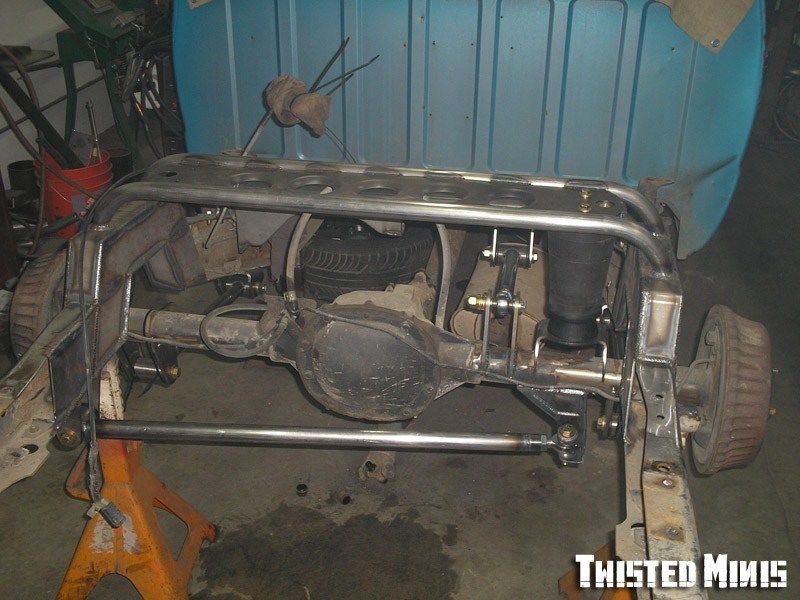

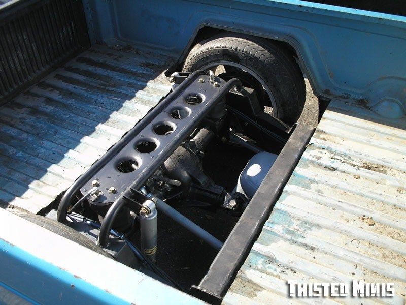

I know space is cramped for you, but I believe that you can fit a good link setup under your bed without sacrificing much. It would be tricky I'm sure, but definitely could be done.
