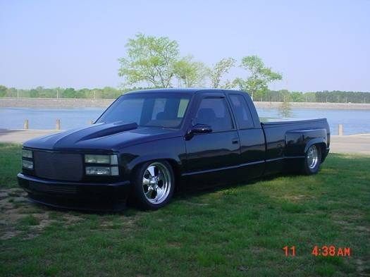

 The only issue would  just the fuel filler, if it's going to be shaved no big deal. The dually fenders on a 6 foot bed looks alot different. Kinda unproportional on a crew cab. Might look pretty good on an ext. cab on the ground. Here is a pic i found of short bed dually.
