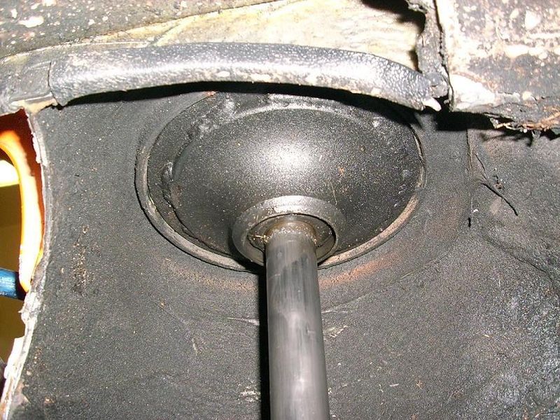

Here is a way to do it using a powerball

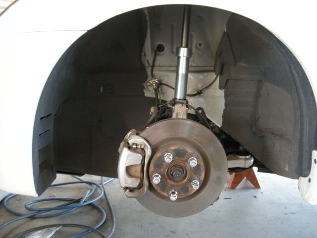

I wanted something with tighter tolerances than a powerball so I used a sperical bearing. I also had to run the cylinder higher than the tower to lay out.

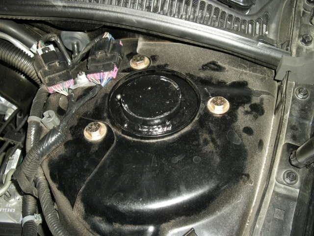

On mine I bought some factory replacement upper mounts and had the mount and the cylinder machined to mount up like a factory strut would. Both are keyed so the cylinder cant loosen up. I didn't run any powerballs and haven't had any problems, it's my daily too. I think I have some pics of it somewhere if you want an idea of something like this.

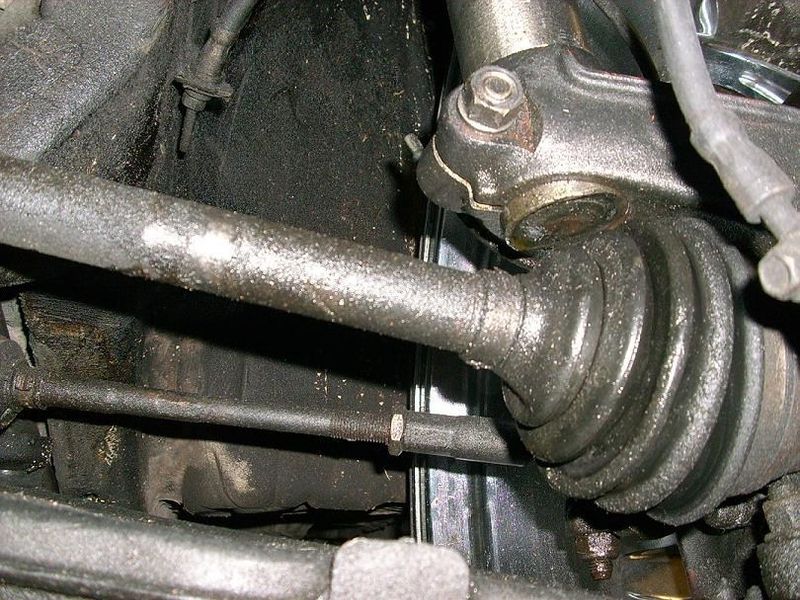

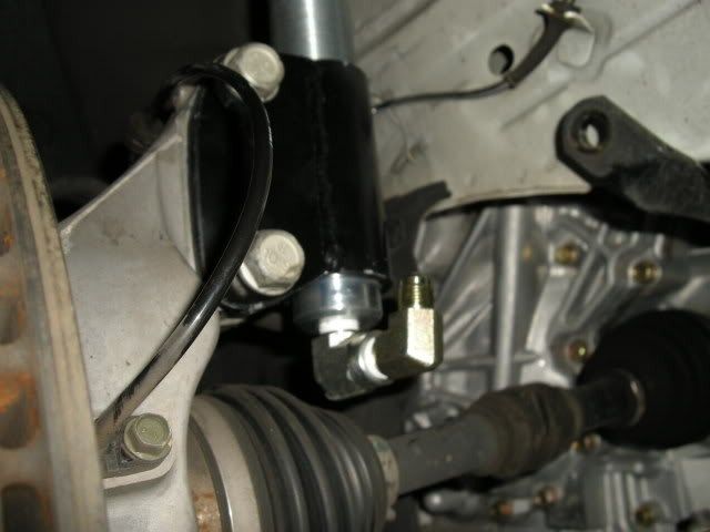

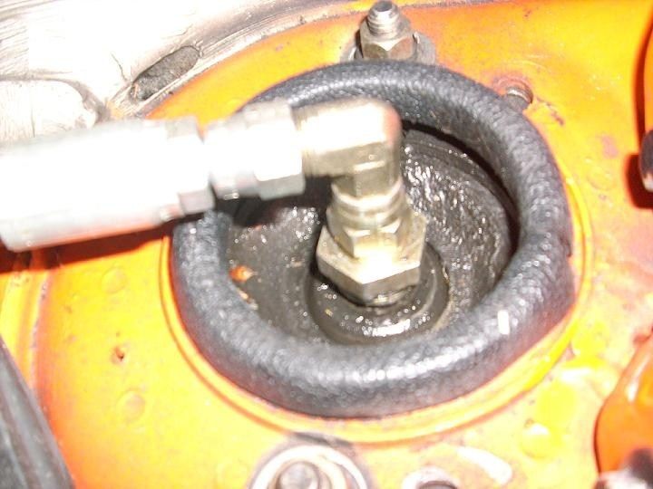

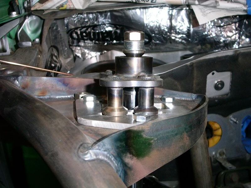

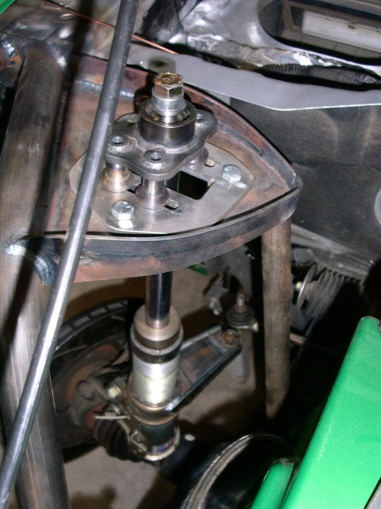

 This is how the cylinders in my VW are mounted.  The top 2 pics are the mystery mounts.  I got them from a guy several years ago, and they seem to work fine.  I would really like to find something like this for the Mini Cooper.  The cylinder is so close to the axle at the bottom that I have to run reverse flow cylinders.  Anyone know who makes these or can find me some.  Thanks for your help guys.
