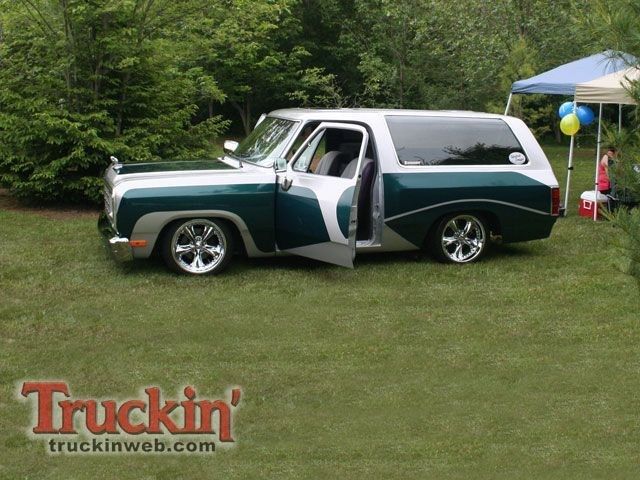

Hey guys I am going to drop my RC and was wondering what ways will work to drop the front? I'm not sure what parts from other trucks might work since nothing is available for these trucks. I'd like to drop the front 4 or 5 inches. Any help would be great! I think its LoAsian that has a RC identical to mine that lays body. Thats sick!

Get a hold of Big Mike at Gauge Magazine. He know alot about what parts to used if you want to stick with dodge stuff. http://www.streetsource.com/forum/topic.aspx?topic_id=113798&Page=1  On the one I did, I used a 85 c10 front clip and built a new frame.
