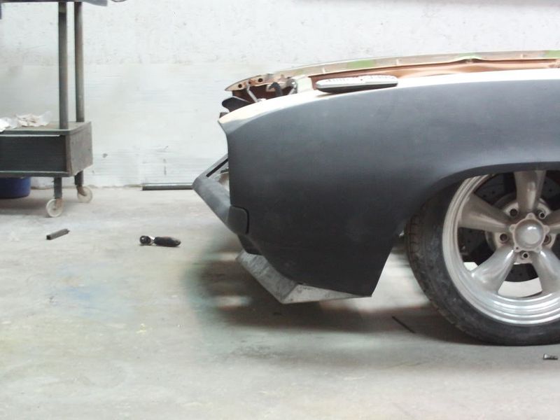

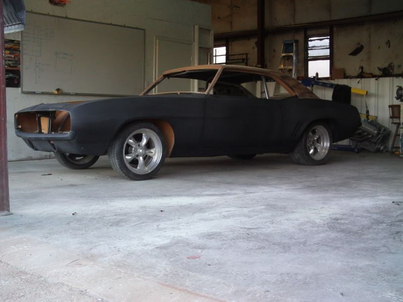

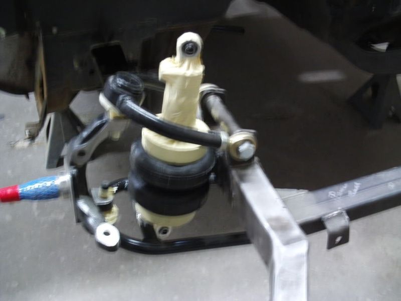

well here she is. bagged with shockwaves all around and hand built (well tuned with alot of hours of math) suspention with satchel link in rear and more body mods than you can shake a stick at. any questions just ask. car is being built by josey sandy of THE TOY STORE fabrications.

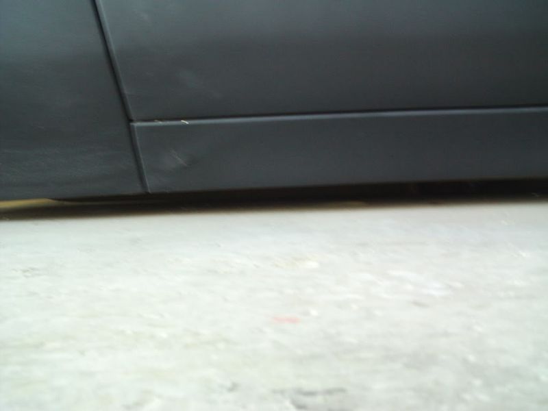

Badass. How low does it sit? Any pics?

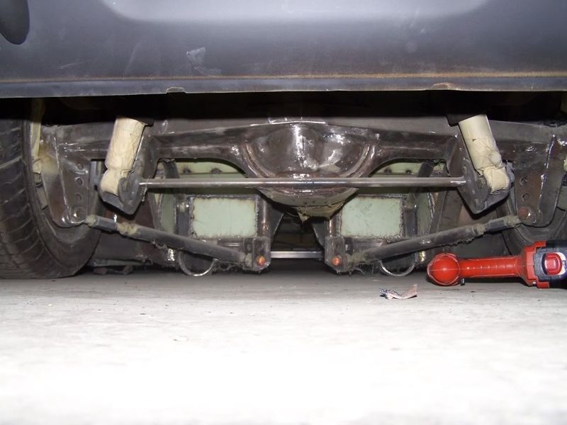

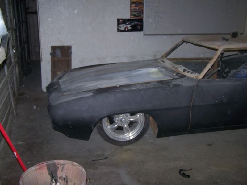

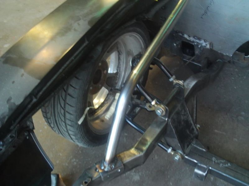

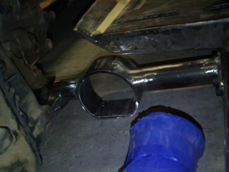

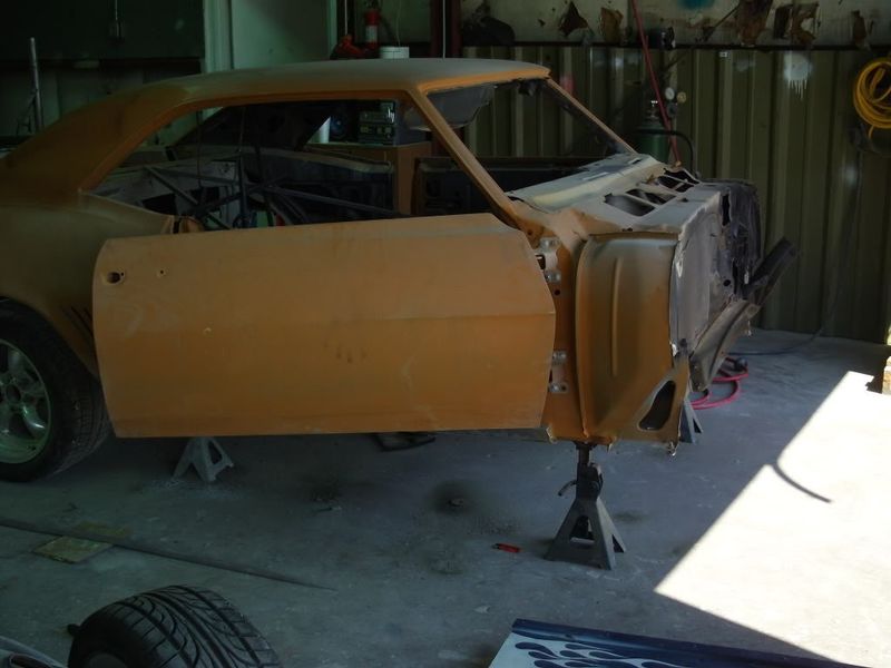

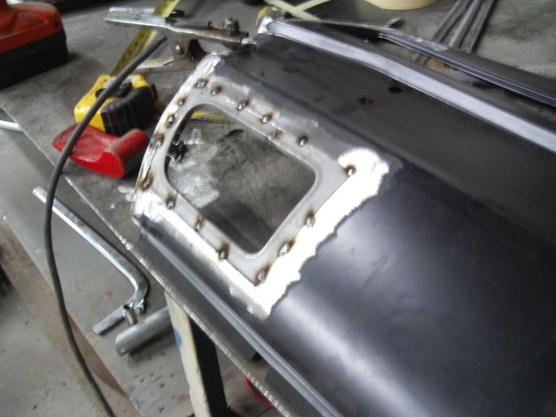

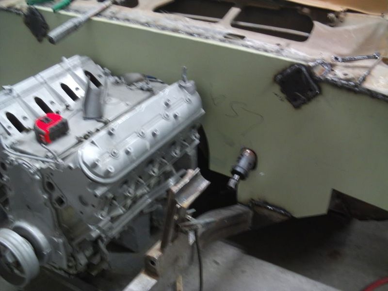

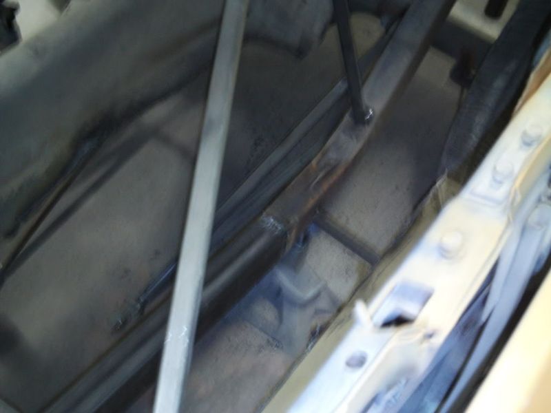

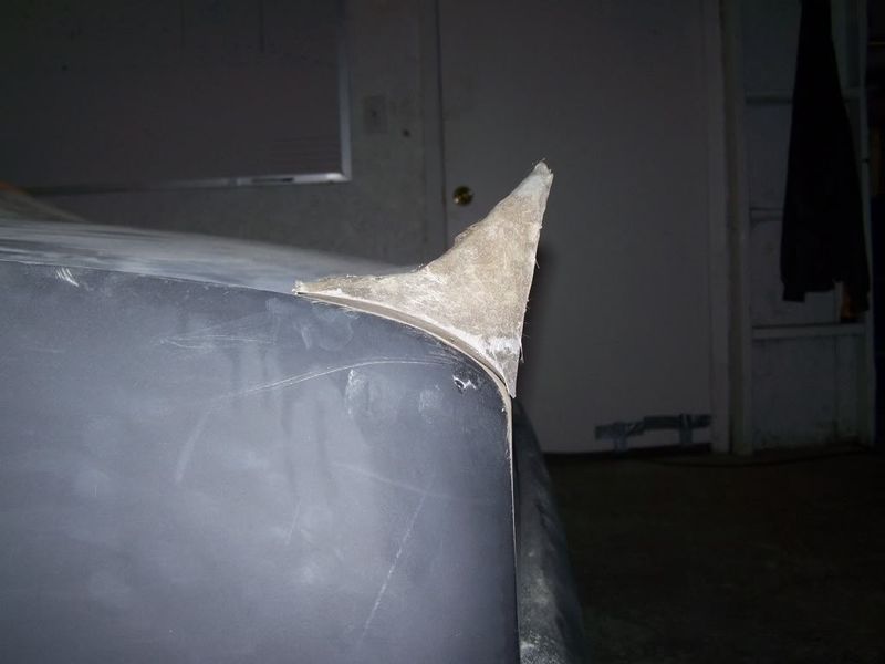

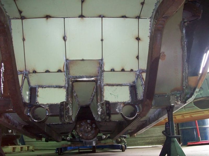

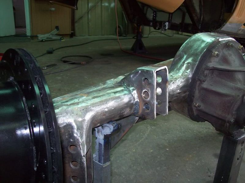

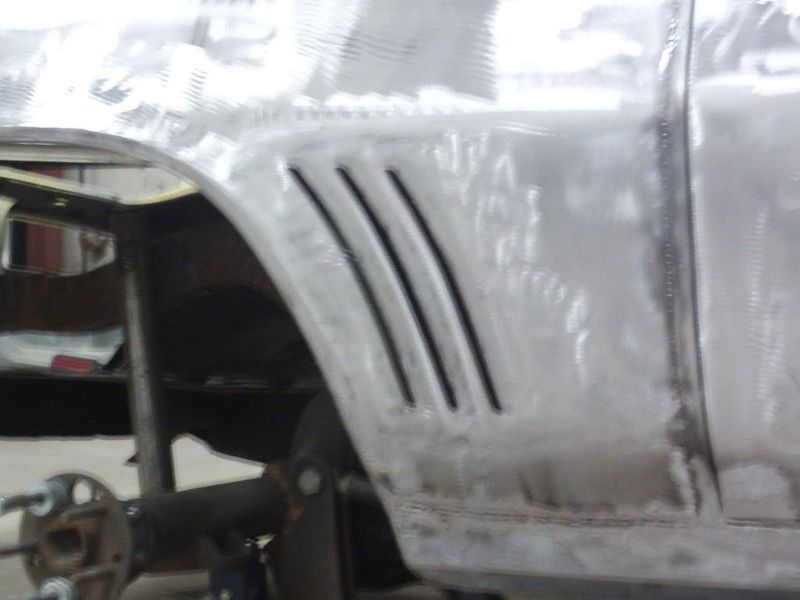

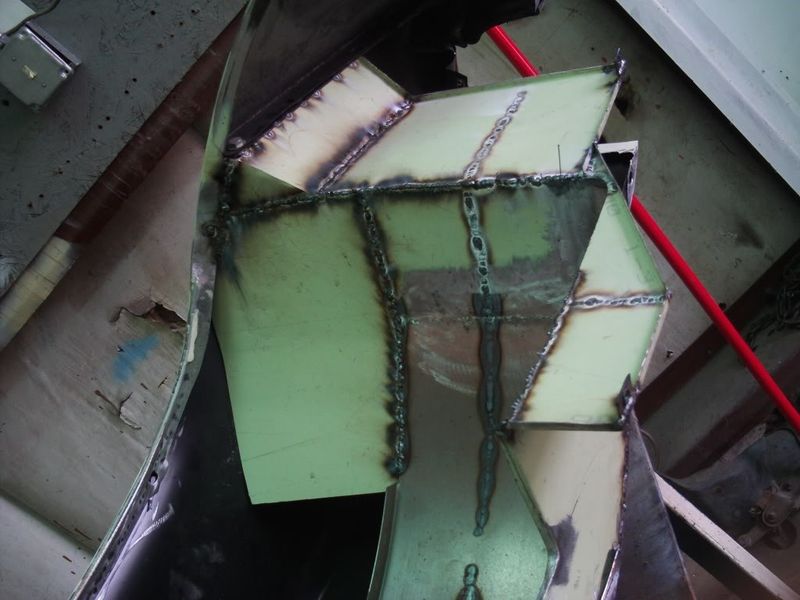

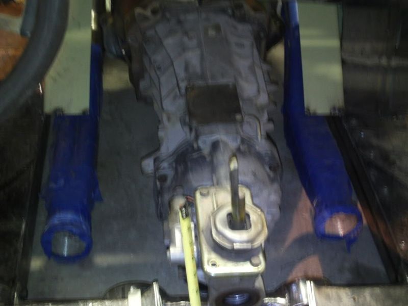

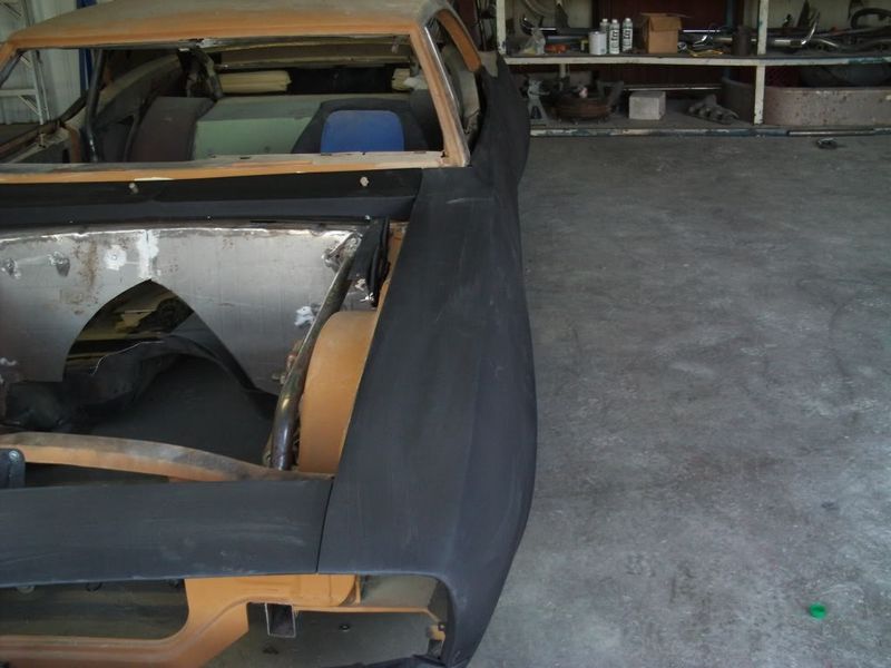

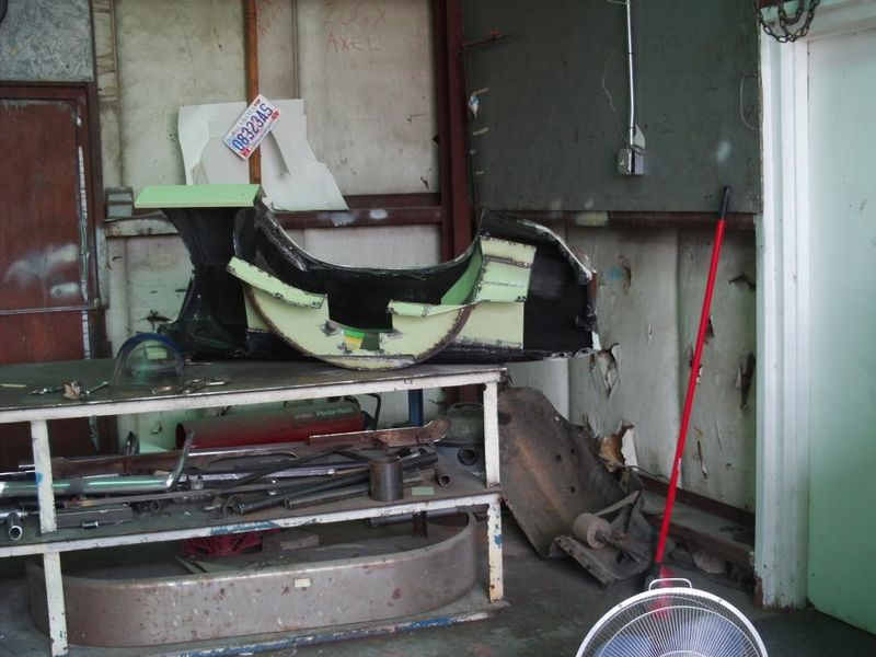

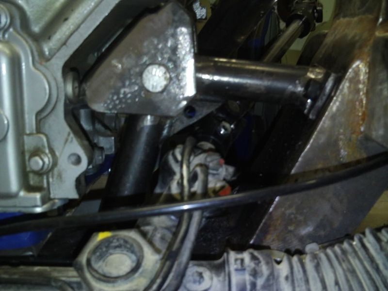

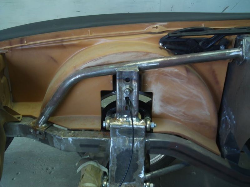

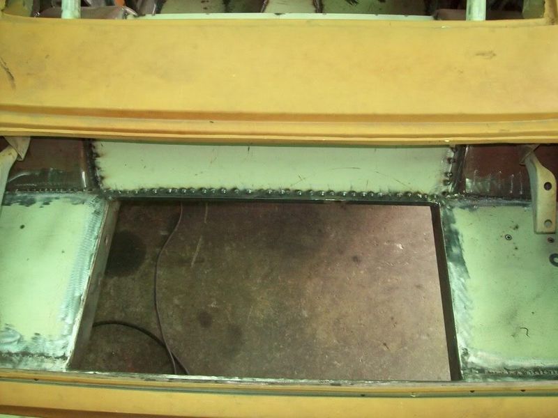

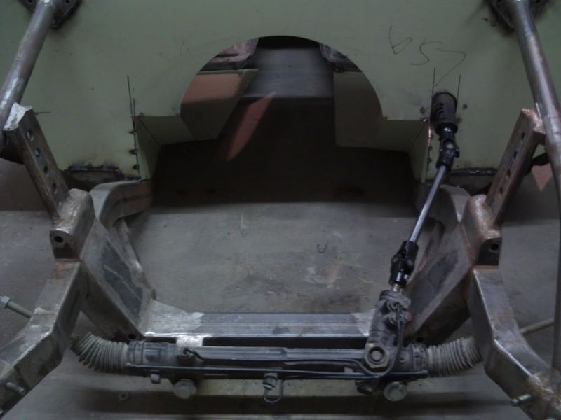

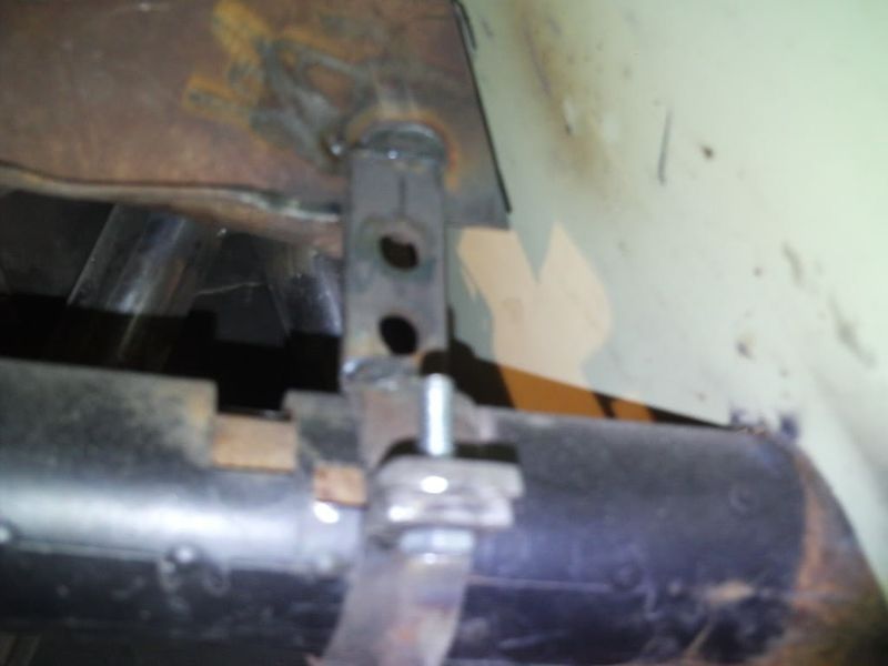

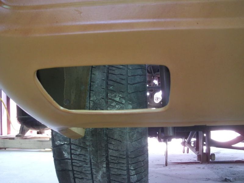

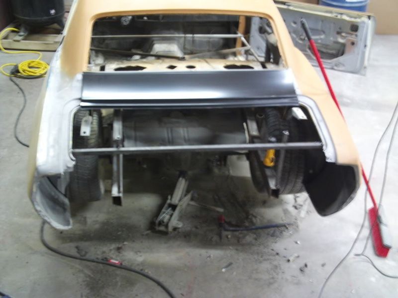

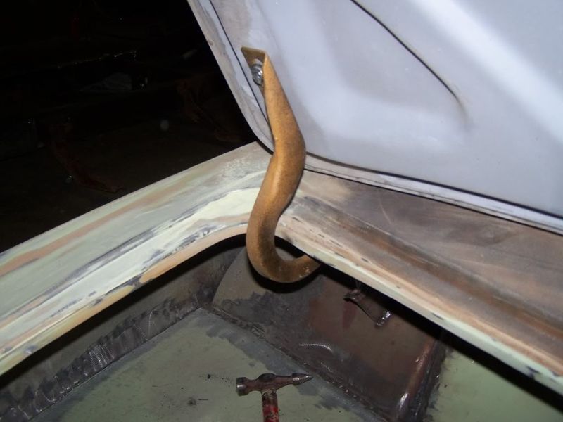

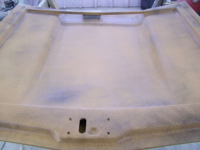

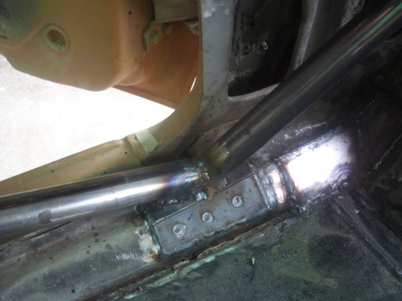

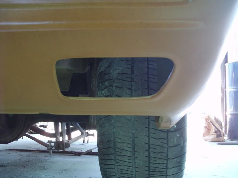

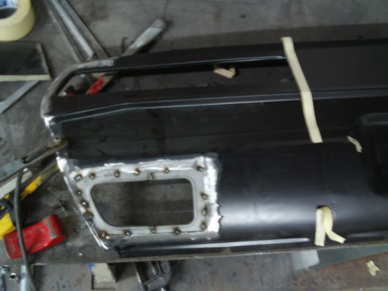

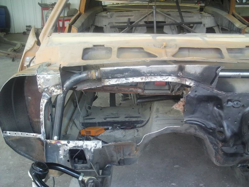

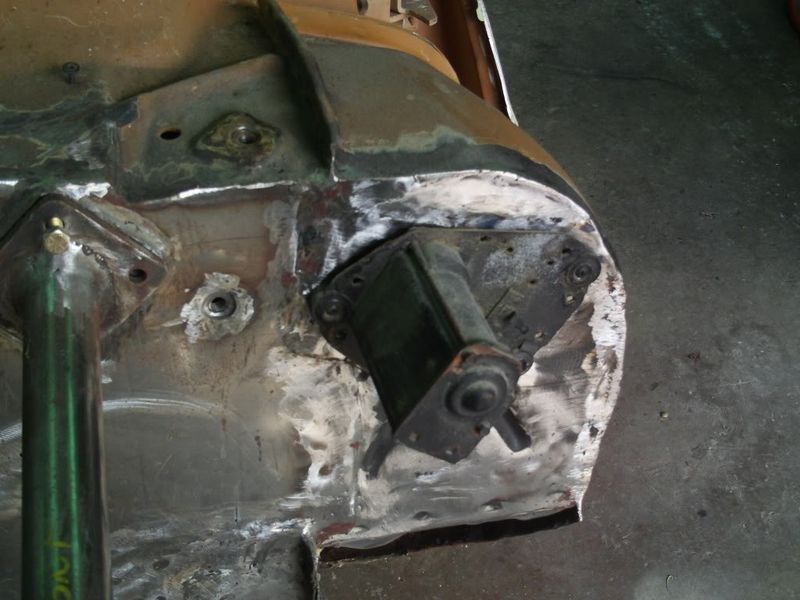

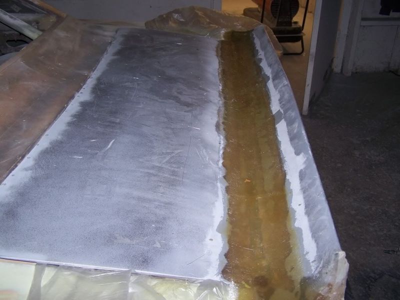

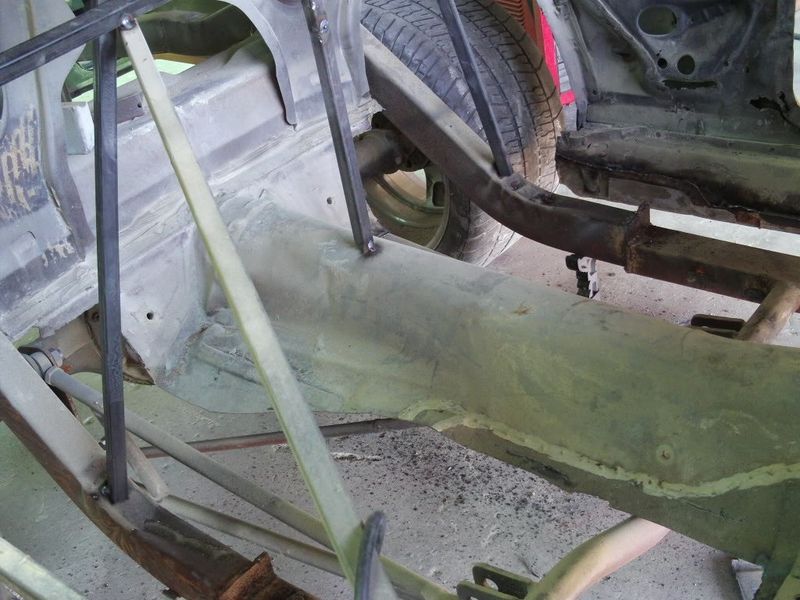

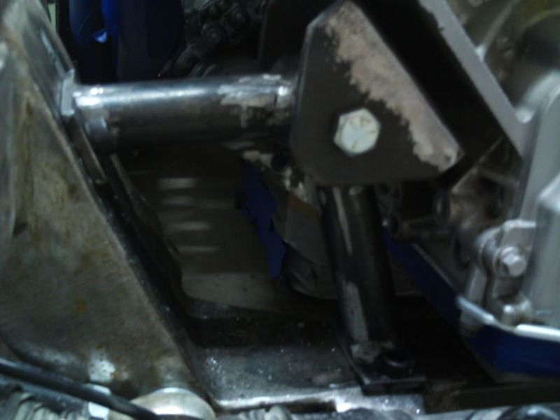

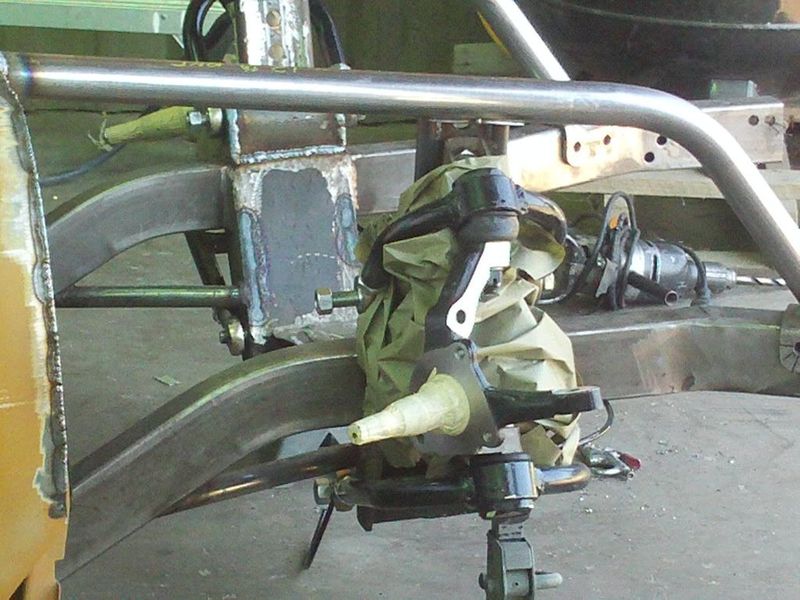

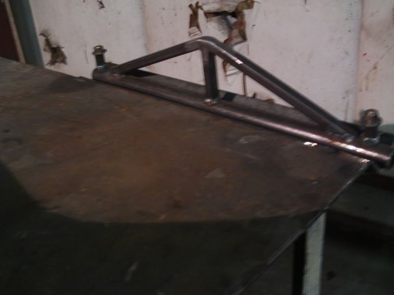

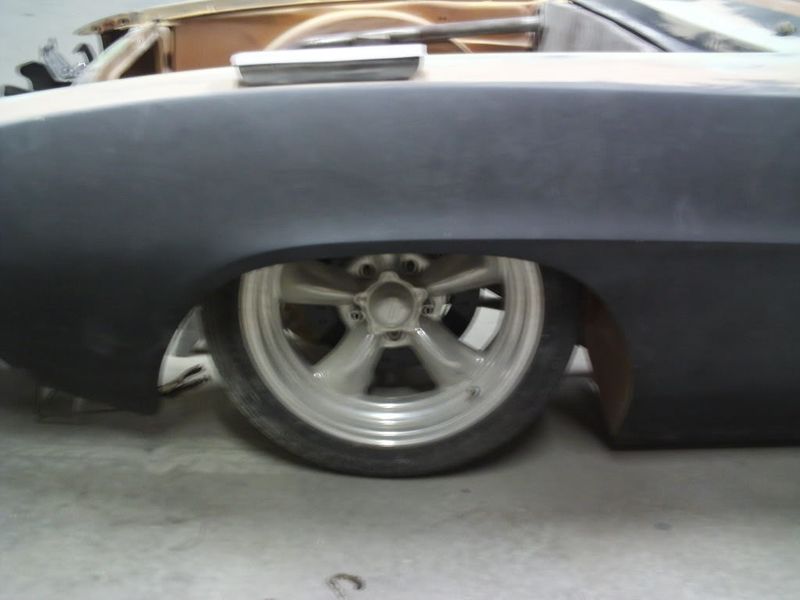

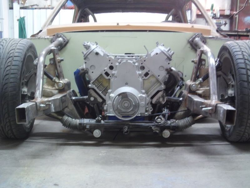

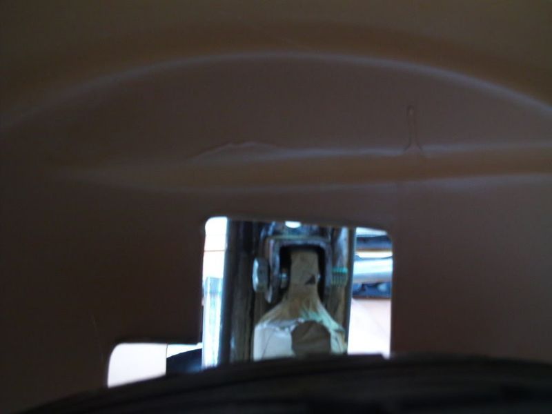

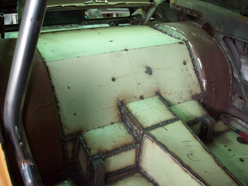

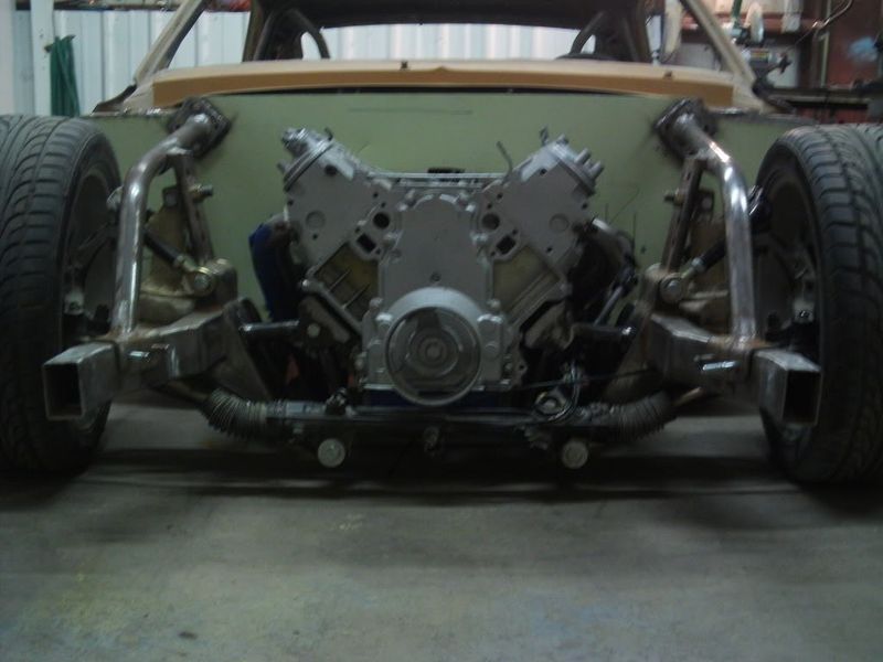

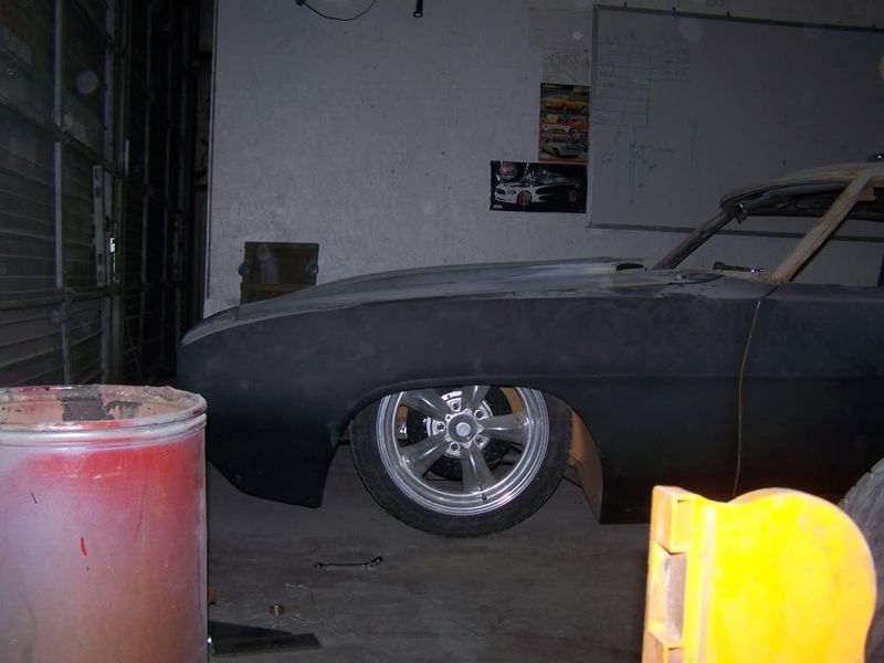

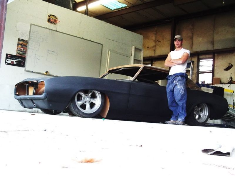

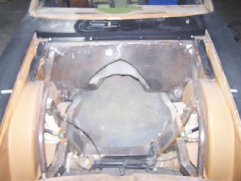

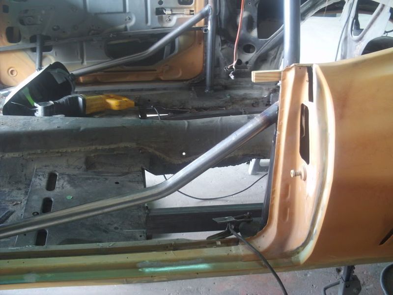

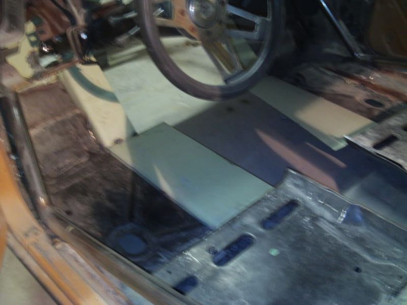

how i made exhoust cutouts in the rollpan. front subframe i made and roll bar hoops. there is a large hoop behind the firewall that you can see that the hoops bolt to. building upper shockwave mounts bullet proof 9in built for satchell link to save floor space and should have great handleing floor built around suspention and with good clearance for 3.5 exhoust trunk floor will have a stainless fuel cell in the open hole bulkhead and relocated wiper motor to under the fender building inner fenders to work around wheels suspention and rollcage. body flared about 4 inches car lays frame and body is 1in from ground. as far as i know this is the first and only bodydroped and lowest 69 in the world. car will run a ls based 427 smallblock with hand fab'd intake and viper spec t56 in the talks with getting some one off 18-19 in rushforth wheels. interior will be all black leather and satin. custom dash and center console will be made in the form of a cockpit. as far as body mods go countless parts have been shaved off or grafted, every body panel has been worked in some way from shaved handles and markers to suddly widened fenders, so it can turn lock to lock even layed out without touching the body. any other questions just ask i have atleast a 100 more pics and more work being done everyday
