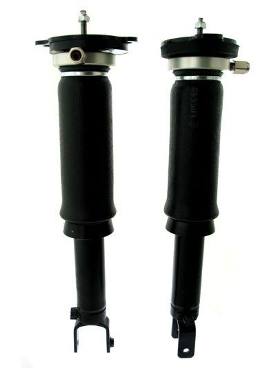

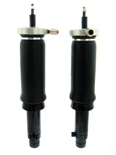

---------------------------------------------Originally posted by deric12Anyone got any pics for reference on bagging or juicing these cars?Deric92 Honda Accord (daily)93 Isuzu Pickup (R.I.P.)---------------------------------------------90 honda accord air cyclinder kit for the honda in pic   4 of these 608.00 LRD-80 Air Cylinder 3.25 diameter x4.75 stroke, Parker P1L equivelantworks well on 88-00 Civic, CRX, DelSol, Accord (1/2 port on top 2 3/8ports on side 4 10MM mountingholes)NOT TO BE USED ON A MACPHERSON CAR     4 of these 696.00  LRD-100 Air Cylinder 4 diameter x4.75 stroke, 3/4-16 thread on shaftParker P1L equivelant works well on88-00 Civic, CRX, Del Sol, Accord(1/2 port on top 2 3/8 ports onside 4 10MM mounting holes)NOT TO BE USED ON A MACPHERSON CAR   bracket kit 200.00        AIR-75660 90-97 Accord Rear Kit600.00 pair    AIR-75440 Front strut kit fits:90-97 Accord92-00 Civic92-95 CRX93-97 Del Sol  600.00 pair   LRD AIR MGT KIT #61 VIAIR 460C8 Asco 3/8 VALVES1 10 SWITCH BOX1 PRESSURE SWITCH 110/1451 RELAY2 EASY ST DUAL NEEDLE GAUGES 220psi1 EASY ST TANK GAUGE 200psi50' 3/8 DOT LINE & 50' 1/4 DOT LINE1 5 GAL 8 PORT AIR TANK1 250psi SAFETY VALVEKIT LESS AIR BAGS                                          800.00 for kit  600.00 for front strut bags 600.00 for rear strut bags total 2000.00 with out shipping   air cyclinder kit with lrd 80 608.00air managment kit #6 800.00 bracket kit 200.001608.00 b4 shipping  air cyclinder kit lrd 100  696.00bracket kit 200.00 air managment kit #6 800.001696.00 total b4 shipping  239-560-3498fredstinting@yahoo.comcan ship aynwhere in usa
