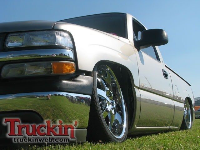

my buddy just bagged his on 22s and didnt shorten the rearend....he did however have to flare each bedside out about 1/2 inch, but its not noticable at all...It also really depends on your width and offset of the wheels you choose

cool thank u flareing it outs not a problem. did he use bolt on or weld on. also that trucks sick

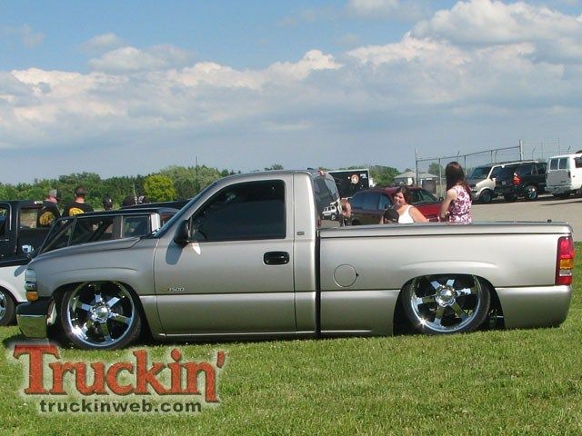

its got a 3 link w/ panhard that he fabbed up himself and installed... also heres a better pic of the bedside....can't even tell

damn thats nice. what wheel is that and what r the specs. and what did he use to flare the bed.
