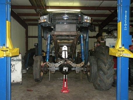

Here is some more pics of the chassis...Here is some of the body mounts we did for the cab and bed:
diggindixie
Here's a pic of the chassis we started to build from scratch.
