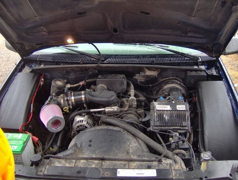

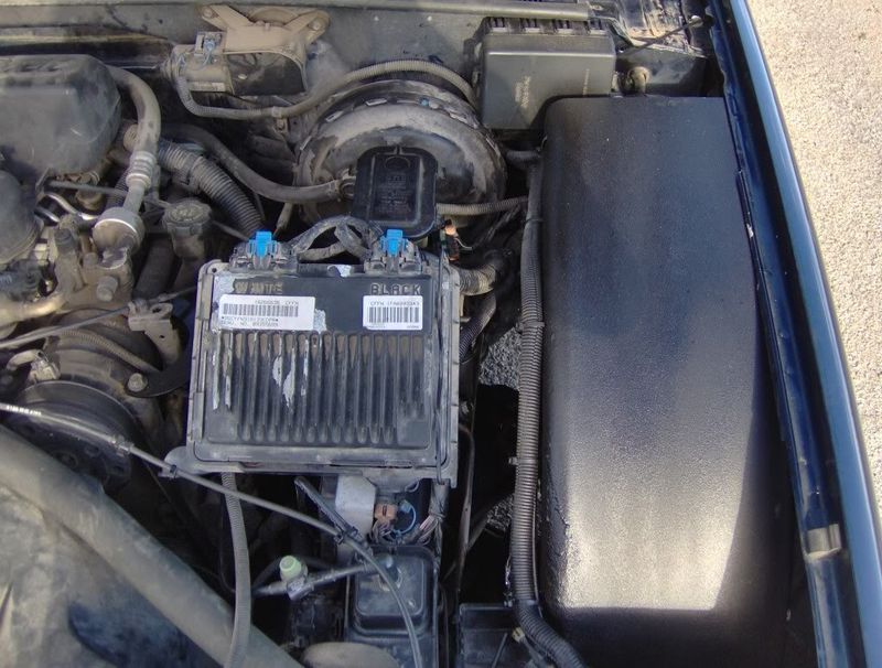

mine is a 96 bd to the rockers on 22's.-ditched abs-mounted computer vertically just in front of the master cylinder-fuse relay center is right under master cylinder ( makes changing fuses kinda a pain but there's still room).-no wires extended and still have cruise. and mine still had room for wheel tubs, but ya you'll have to lose the hood springs too.

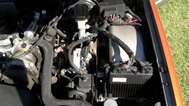

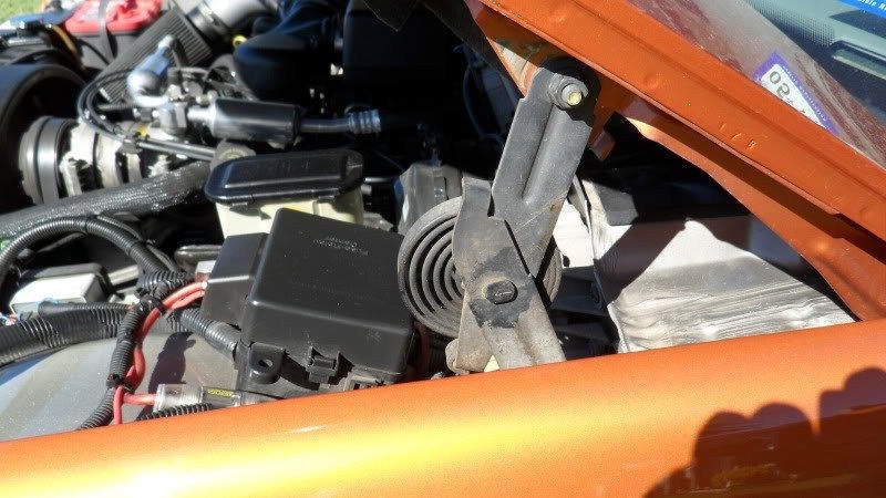

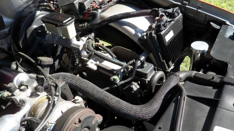

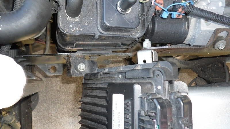

Here are some pics of mine.99 burb set up for 24" but on 22" Keep ABS mounted sideways Keep stock hood  hinges just cut down tubs with Fuse box nounted on top No wires to extend No pic put pass side moved wire harness throught fire wall made plate to cover hole.
