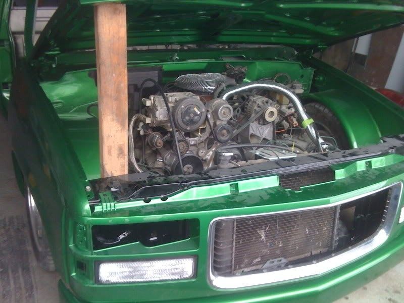

also, you might look at his pics it might show on there. he also, makes the brackets to mount them if you don't allready have them >>>   Choppedmazda
