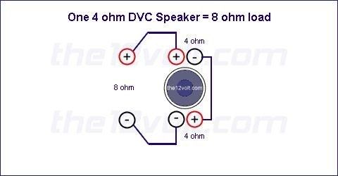

i just redid it, i had just the + wire from channel 1 and the - wire from channel 2 going to a + and - set on the sub. but i knew that wasnt right, so i put the - wire to the other side of the sub and put another wire from one of the other + to a - on the sub... i ended up like this:^thats pretty much it. i used 2 of the 4 + hook ups and 2 of the 4 - hook ups on the sub. (the outside ones)
