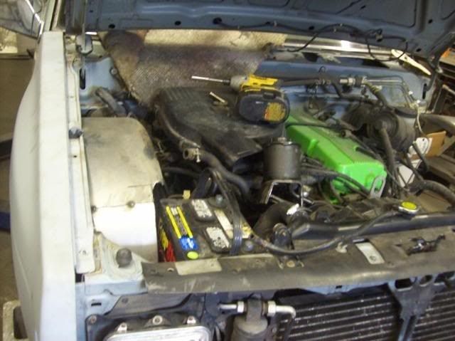

Im try n to find out were to run the wireing harness and someother things if you have pics of yoour frount end after you tubbed it would you post them please and thanks

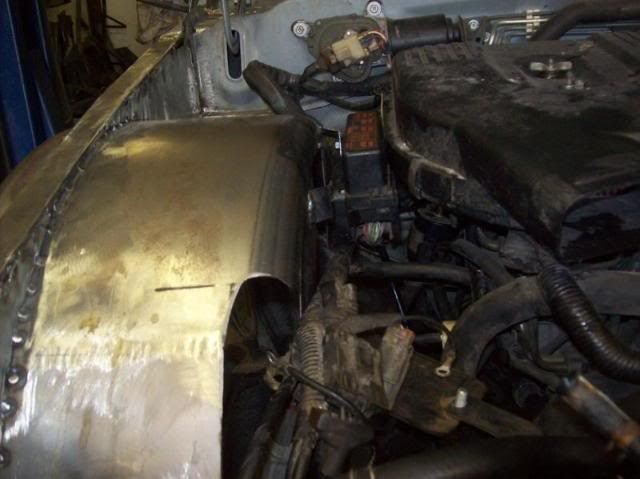

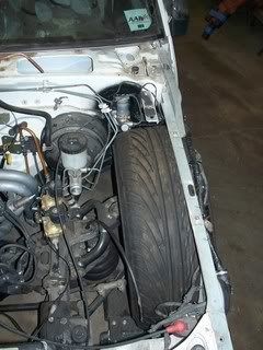

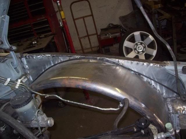

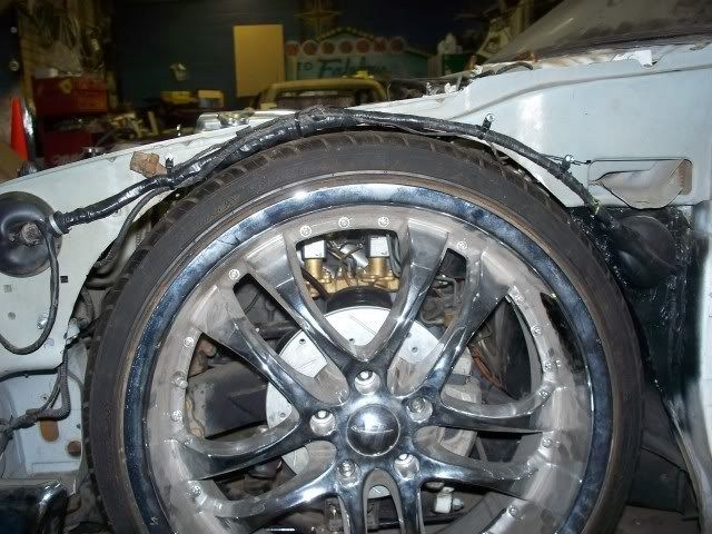

dam thats were im at to day,what did you do with the big harness on the pass side??( just slid it down )do u have 20's too,are you gona use the GEO metro brake boster
hrdnissan's avatar
hrdnissan
stcaddad's avatar
stcaddad

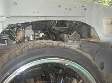

Ya its body droped on 20s used the stock booster. we moved the pasanger side wires to the inside of the tire tubs on the firewall
hrdnissan's avatar
hrdnissan
o ok i was like dam that shit looks thin..cool thanks.did you flip the a-arms
hrdnissan's avatar
hrdnissan
lets see under the hood guys,
1twztdwagon
sup kendall andre did my truck flipped the upper arms swapped sides i have the geo booster the rear bolts have to be lengthened the shaft has to be lengthened on it the wiring harness is routed towards the motor i dont have drop spindles he customized my lowers
