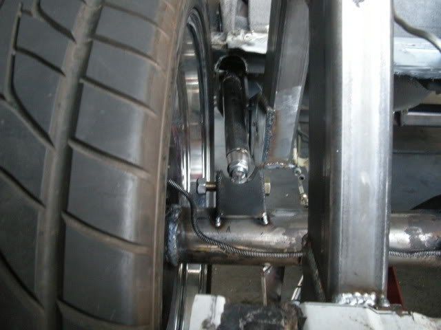

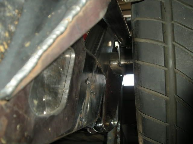

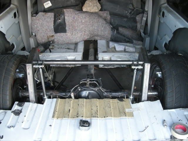

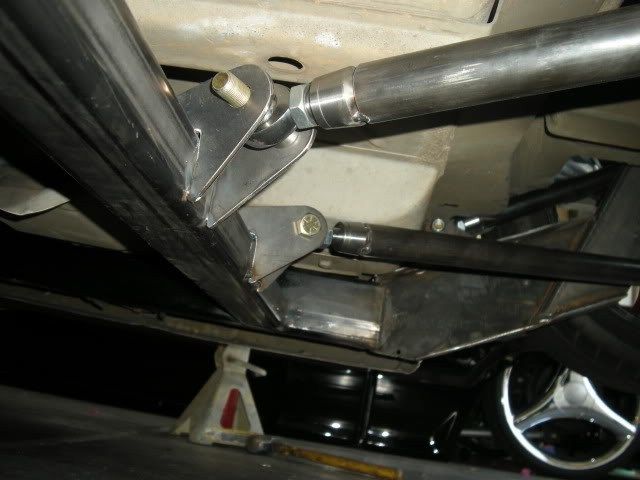

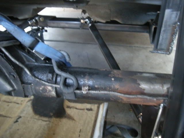

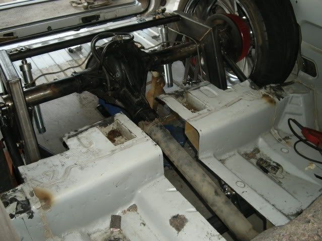

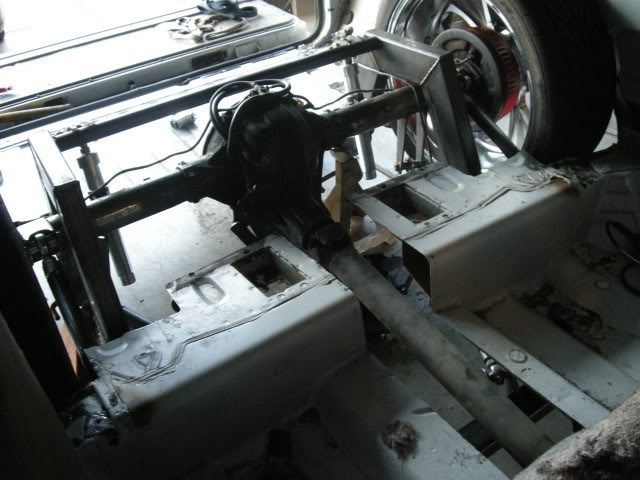

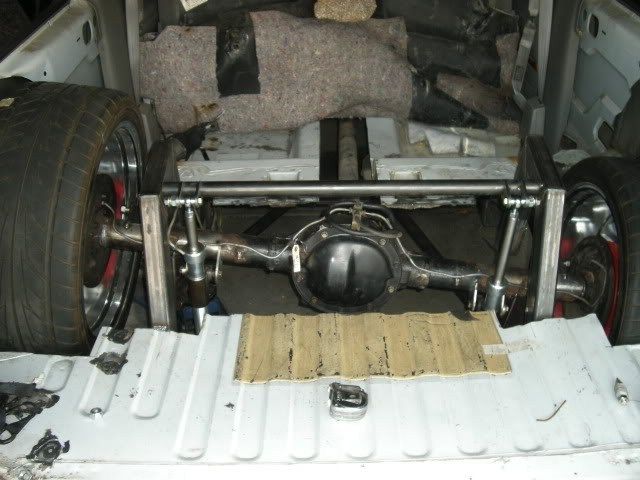

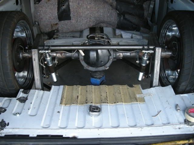

Here is how I did a Tahoe...
post photo post photo post photo post photo post photo post photo post photo post photo post photo

---------------------------------------------Originally posted by tre5Here is how I did a Tahoe... ---------------------------------------------what size wheels are those? did you narrow the rear end? does the drive shaft hit that crossmember for the lower bars?
tre5's avatar
tre5
Edited: 9/1/2009 11:54:39 AM by tre5
It will fit a 24" combo. Those are a 22 with a 285/35. The rear end is narrowed. Those are decent questions. The driveshaft does not hit the crossmember for the lower bars. That was kinda a dumb question. LOL, why would anyone build something that would interfer?
DropEmWear's avatar
DropEmWear
---------------------------------------------Originally posted by tre5Edited: 9/1/2009 11:54:39 AM by tre5It will fit a 24" combo. Those are a 22 with a 285/35. The rear end is narrowed. Those are decent questions. The driveshaft does not hit the crossmember for the lower bars. That was kinda a dumb question. LOL, why would anyone build something that would interfer?---------------------------------------------lol. it just looked close is all. Sorry for the stupid question. Is that a two piece drive shaft?
