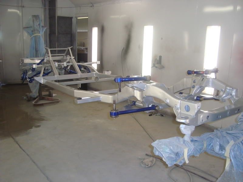

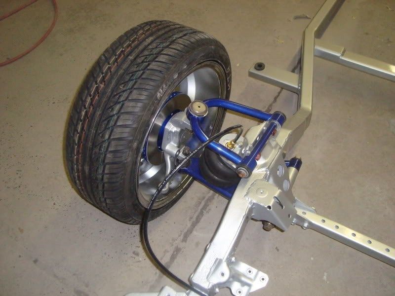

not sure how well you can see it but the frame is notched for the bag to sit closer to the frame and it is a re6 and stays away from the ball joint. I have drop spindles but not sure if thats your problem or if you just need the bag closer to the frame.

Well its all together now so i cant get a better pic but i was looking through and found this one if you look close you can see the dish. I didnt build the frame but i have done this on all my trucks it just seems like a good thing to do and it has a lot of benifets. oh and these are kustom werks arms but i know they are about the same.
