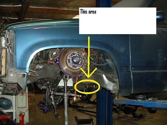

 OK here it is. This isn't my truck in the pictures though. My truck right now is nothing but a frame, engine trans, and suspension. No exhaust holding me up. As soon as my other pic gets approved, I'll post it too, to show my problem, if you don't understand from the wording.
davaflav
yeah you need to pie cut the frame right there or dehump the arms. i would pie cut the frame.just make a like this  > toward the back of the frame right above the bottom and bend it all up tight and weld it back together.

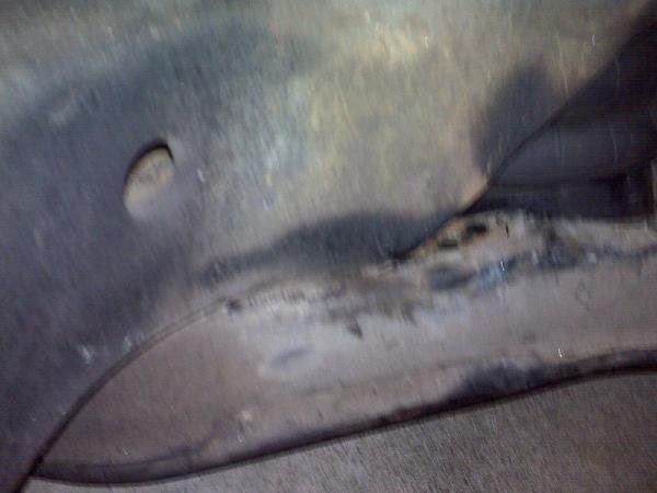

 here is where the frame is laying on the back side of the control arm. I have been told by everyone that you dont have to de hump for 20's, and it looks like i'm gonna have to.
SoloSpecialties's avatar
SoloSpecialties
de hump your arms.
