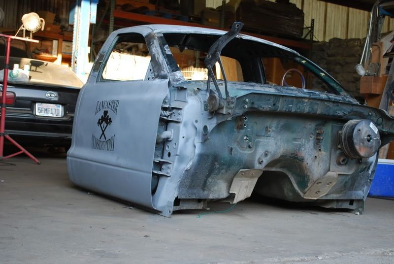

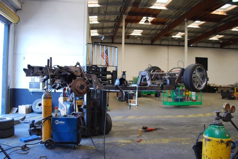

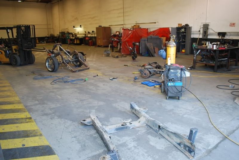

Whats up guys! This is my buddies 97 Dakota were building. These are pics from that last 4 months of building on our spare time. And more to come!
Enjoy!

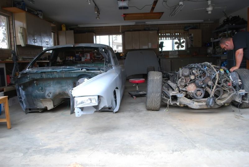

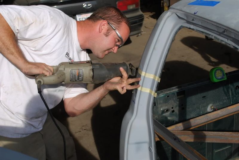

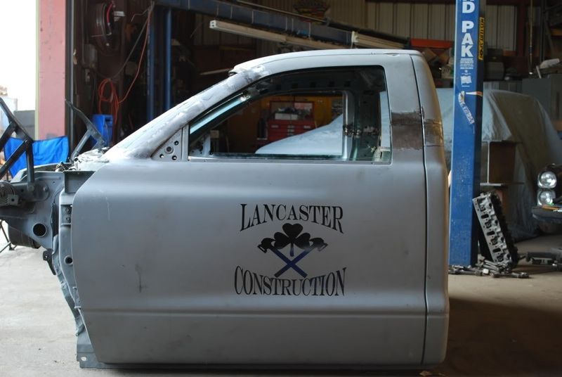

This is a 2inch chop, layed back A pillars, roof widened 1", very litle trimming/ modding of the side window/trim, stock front glass as of right now.   We are also bodydropping the truck past the rocker, power moon roof, sheetmetal bed with wood floor, and suicide doors   Here is todays progress:
post photo post photo post photo post photo post photo post photo post photo

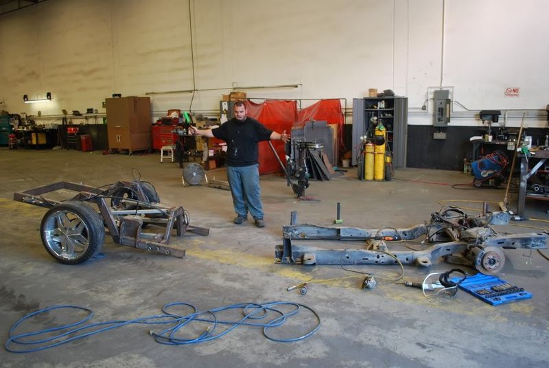

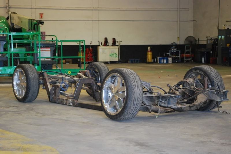

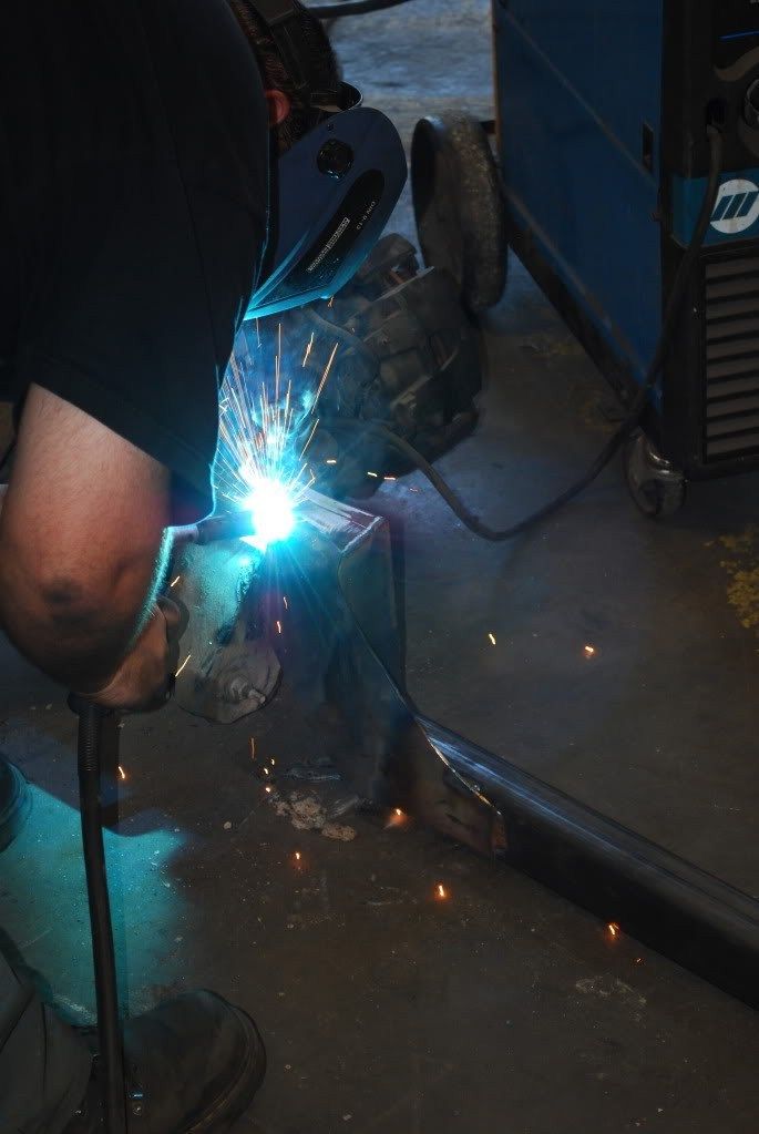

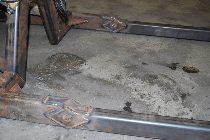

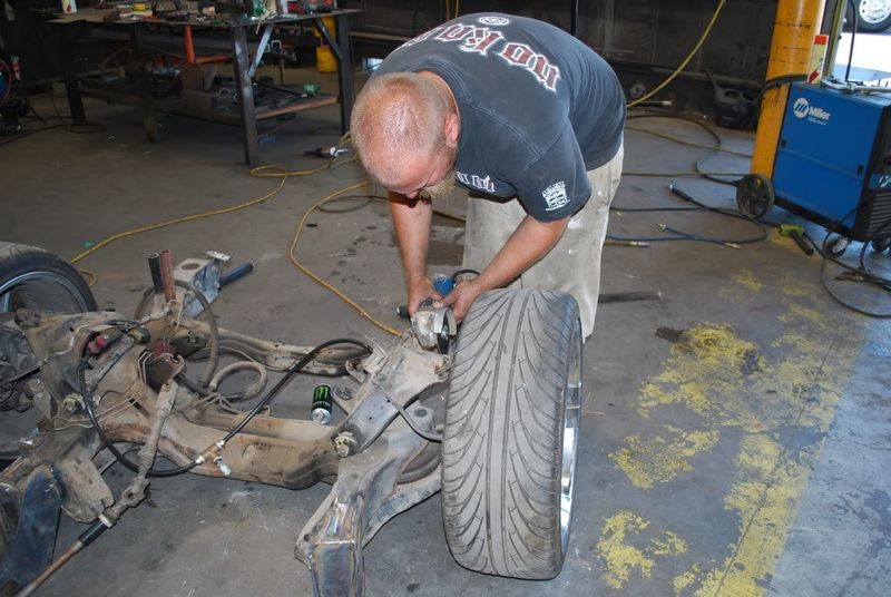

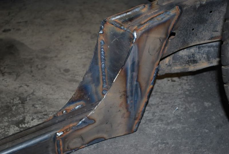

Z'd the frame 2", pie cut the upper arms for better ball joint angle, 2x3 under the cab, 2x4 back half.(it's only this way cuz the owner didnt want to BD the truck at first) The rear bag mounts are getting trown in the gutter and new mounts installed next week. Next week is also installing a new tranny x member and building new, lowered engine mounts from the 2'' z and keeping the motor under the hood. Maybe do the front frame horns if were lucky and get enough time

tre5's avatar
tre5
holy stepped front frame bat man.
