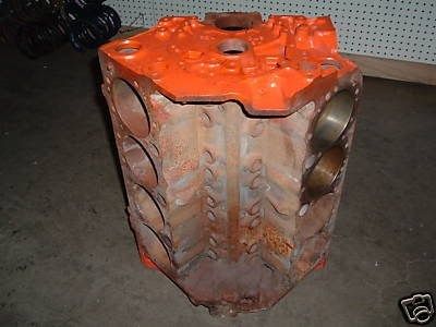

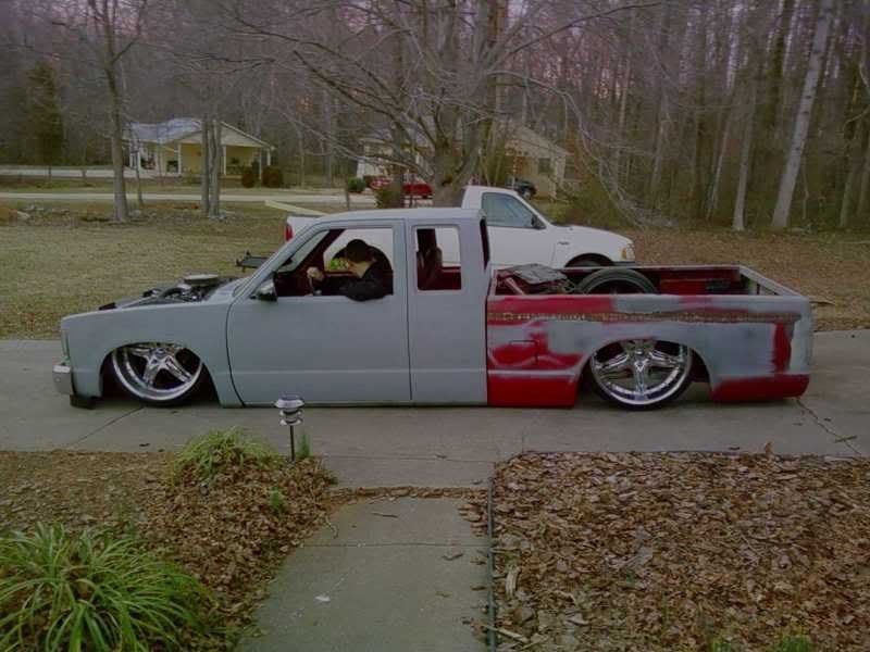

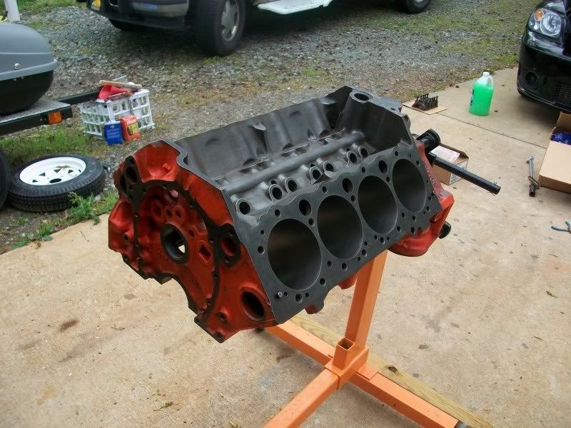

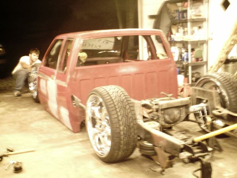

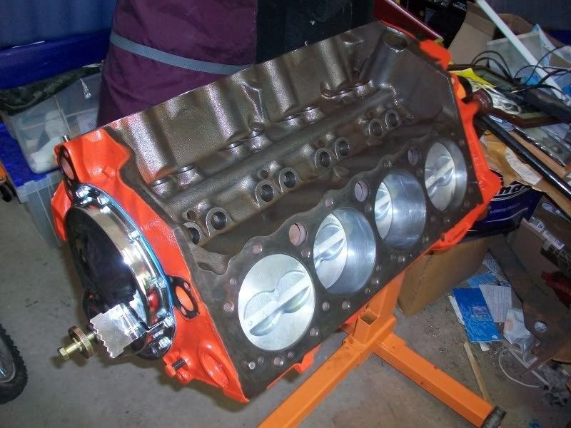

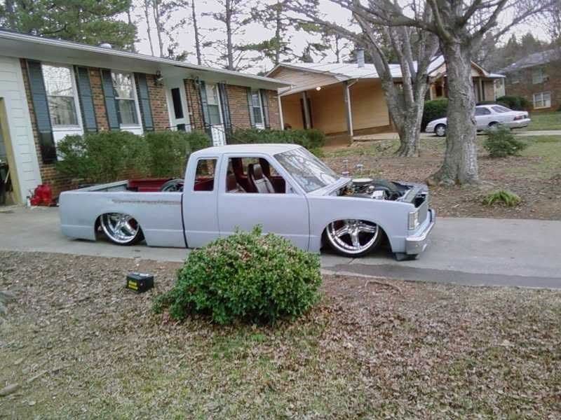

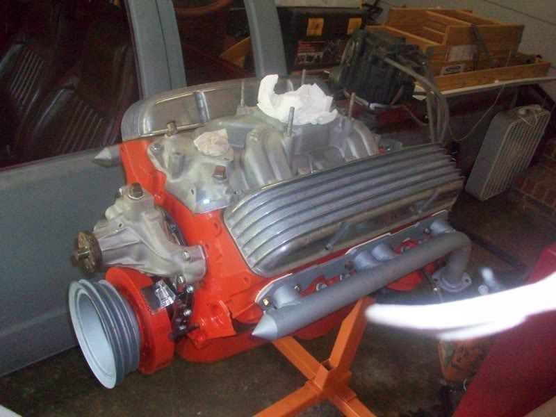

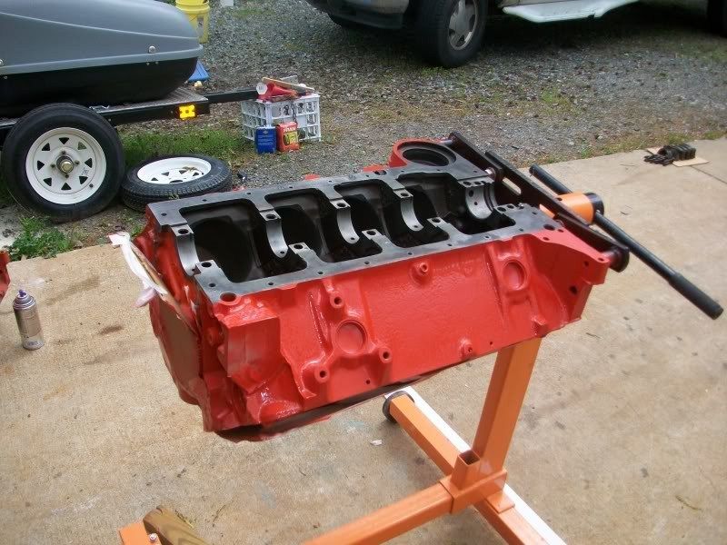

here's mine i built the whole thing with my little bro and my buddy jeremy.  it's stockfloored on 22x9.5" Bigg Hitt's, has a Cando 6 link, stock modified control arms, corvette Becool radiator, and i'm in the middle of building a small block 355 with th400 for it.           and here's the motor.  68 corvette 350 block i got for $56 already bored .030   and here it is nearing completion.  pure old school hotrod with some nice performance shit inside as well.

man thye look huge with that thing body dropped, truck will be nice. diggin the headers   and i have no plans lol, jus random evil thoughts

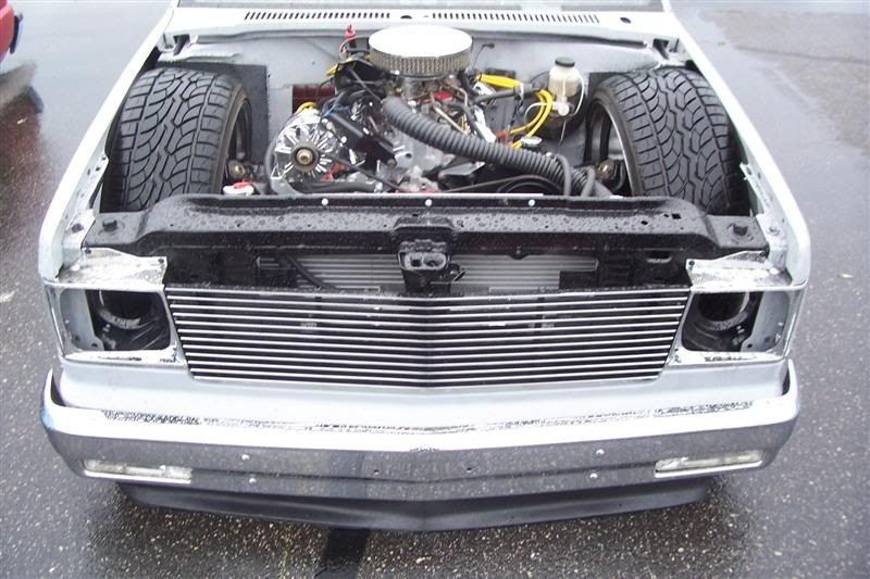

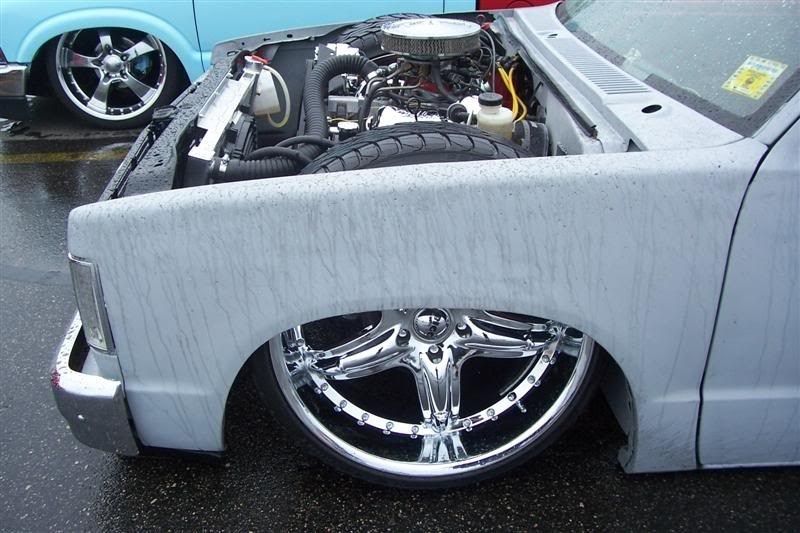

delaware dave's truck, work by little shop

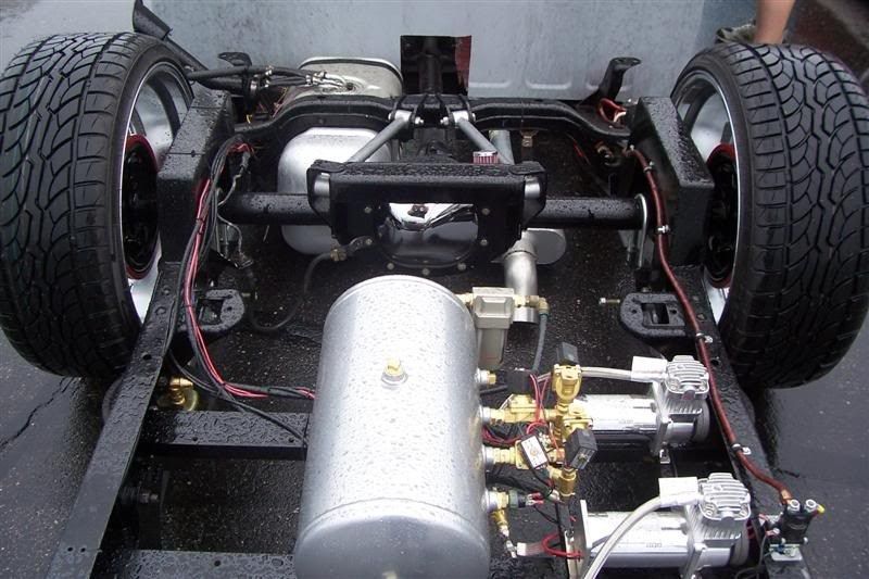

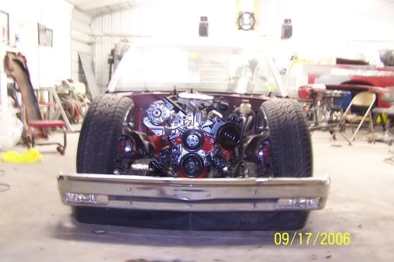

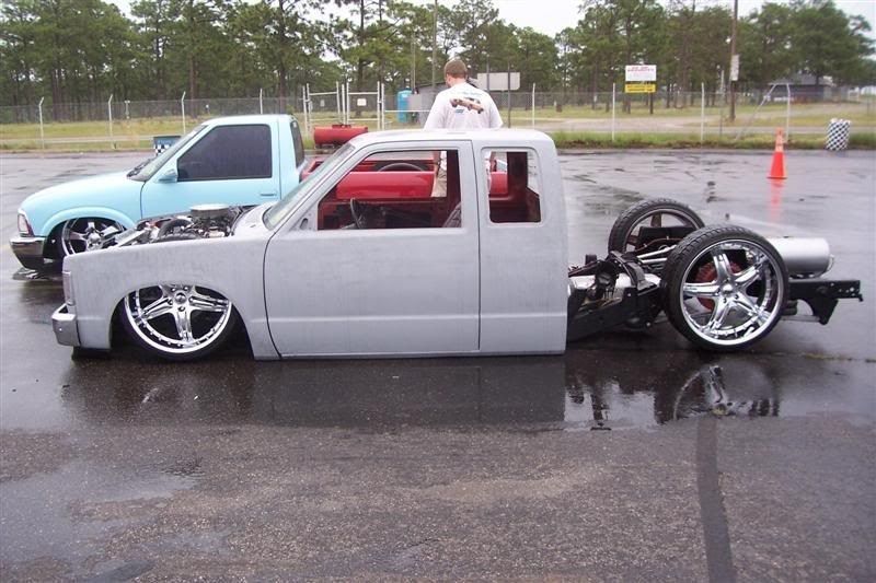

i cut off the lower balljoint and raised it 1 1/4". other than that i added power performance balljoints, piecut the upper arms, and added drop spindles. here's a couple more pics of the truck, engine bay when it had the v6, and the arms       now it had a duap diaphram 7" booster and hotrod master cylinder and no more v6
