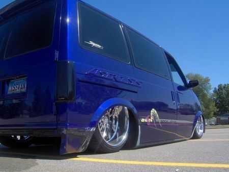

bird u got questions about an astro rear setup? let me know, i just shortened mine. and yes if u dont eliminate the slider track the rear wheels will be about 2 1/2 in less than the front. looks funny when aired up goin down the road. i gullwinged the slider to keep a door on the side.
