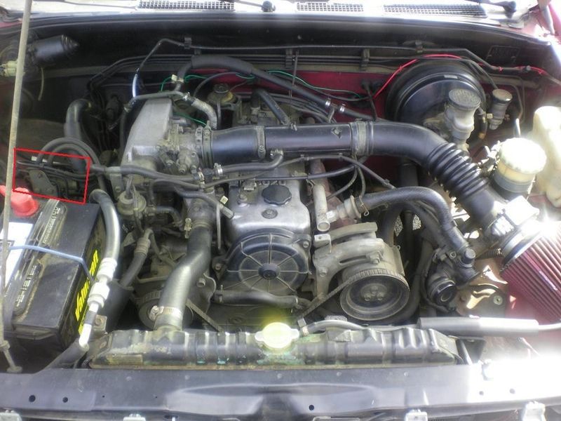

dwatkins
Well, I got to messing with it and unplugged this weird looking thing with two big vacuum lines on the passenger side on the inner fender and it is running just fine now so I guess I gotta replace that when I figure out what it is or if I even need it. But so far it runs fine without it so I dont know.
satchnc's avatar
satchnc
Check this diagram out. If part #19 is what you unplugged, its the fast idle solenoid.   http://myisuzuparts.com/showparts.php
dwatkins
The diagram didnt open. But yeah thats prob it and its hooked back up cause the truck started doing it again so I plugged it back up. Below is a pic and the red rectangle is what I unplugged.
