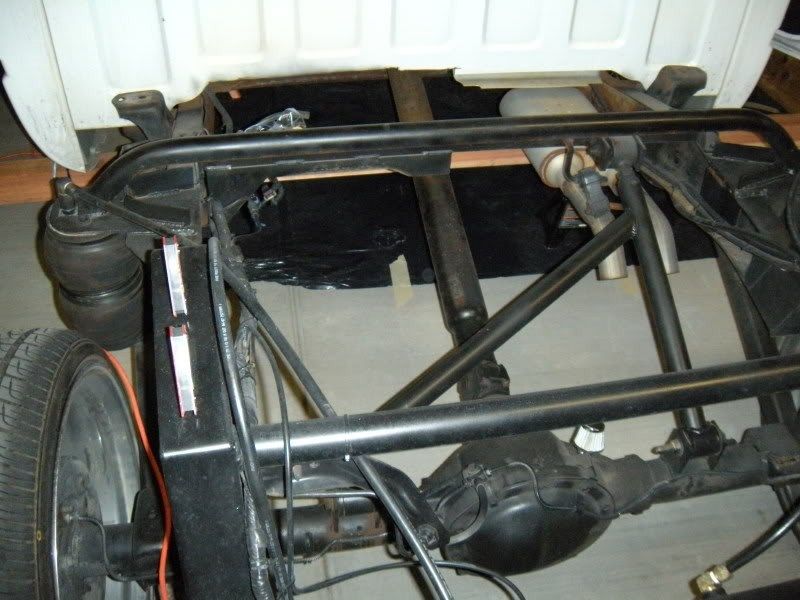

is this a good setup??..

would i still need a lateral movent eliminator for this offset wishbone?
BioMax's avatar
BioMax
That will work fine. I would reinforce the short section of tubing between where the two tubes come together and the super pivot joint. That is the place that "sees" all of the load.
sirangel's avatar
sirangel
awesome..thanks for your 2 cents
CommonVan
you may get some twist out of the lower links with the bag offset to the side.
sirangel's avatar
sirangel
how can i avoid that?
97hrdbdy's avatar
97hrdbdy
Edited: 8/1/2009 12:19:19 PM by Kmanuel
mount them centered on top of the bars not offset to the sidethat will prevent the twisting
MF
Master Fabber
I would do a set of rearward bars with dogbones in board of the frame, bag on bar back where a fuel cell would normally go. God luck. JR
sirangel's avatar
sirangel
how do dogbones work?
BioMax's avatar
BioMax
Dogbone isn't quite the proper terminology for what he's talking about. It would be more like a shackle. What it does is allow you to have a forward 4-link while running 2 bars rearward to mount the bags to. The rearward mounted bars would fight the 4-link if they weren't isolated from the rearend, so shackles would be used to allow the rearend to follow the set path of the 4-link while the rear bars only did lifting duty.
azdragginsoon's avatar
azdragginsoon
Edited: 8/2/2009 3:10:23 PM by azdragginsoon
yea that set up works been running it for 2 yrs now the bars twist alittle , i would try and center them more , and put a brace on the top of the upper bag mount ...and i did think about putting a gusset in but it hasnt cracked yet...
