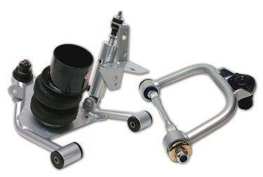

who makes or what is the best upper and lower arms for a 98 plus ranger. money is an object so if someone has a way to lay out 20s by just modifing the sock that would be great

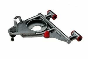

with a bag do u  put it down in spring cup or plate it.. i have not seen the control arms yet thatys why i ask. and if u run just loweres in what way do u modify the uppers to correct  most of the camber as well as arm travel and ball joint binding

just get the uppers n loweres. you can do either with the lowers. also make sure the upper ball joints are clocked in teh right way.

U cant flip the uppers!!! i wouldnt flip the lowers either, just get djm arms put a small cup in the bottom to bring the bag up to 3"(compressed) when laidout, then move ur upper mounts up @2inches and get soome good eliptical ball joints for the top. BEST THING TO DO IS PLAY WITH UR SUSPENSION ON A RACK OR JACK STANDS AND WATCH WHAT IT DOES THRU THE CYCLE, THEM MAKE CHANGES AS NECESSARY

for the djms MOOG

i would say djm if you where just lowering the truck static drop only  i sale the djm parts they make a great control arm   but for 20's or bigger for bags i would say either air ride technologies
