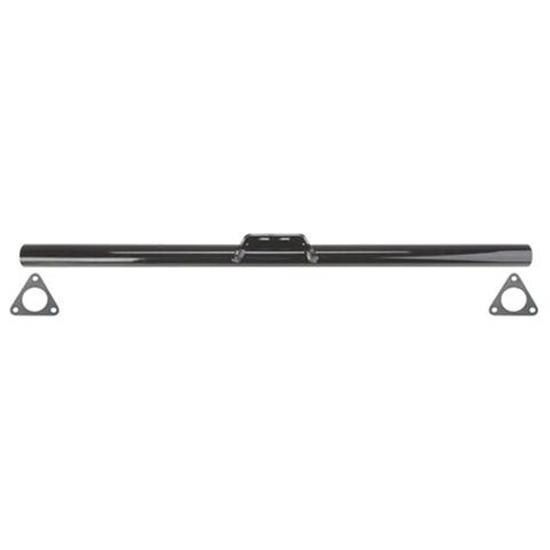

I built a new one like this, but I see how it could be a pain to take out. Hopefully I won't have to. I guess, if the tranny has to come out, unbolt it and slide the x-member back far enough to clear. I installed it with the cab off. The only thing I did different was made to rectangle plates instead of the triangle ones pictured.
